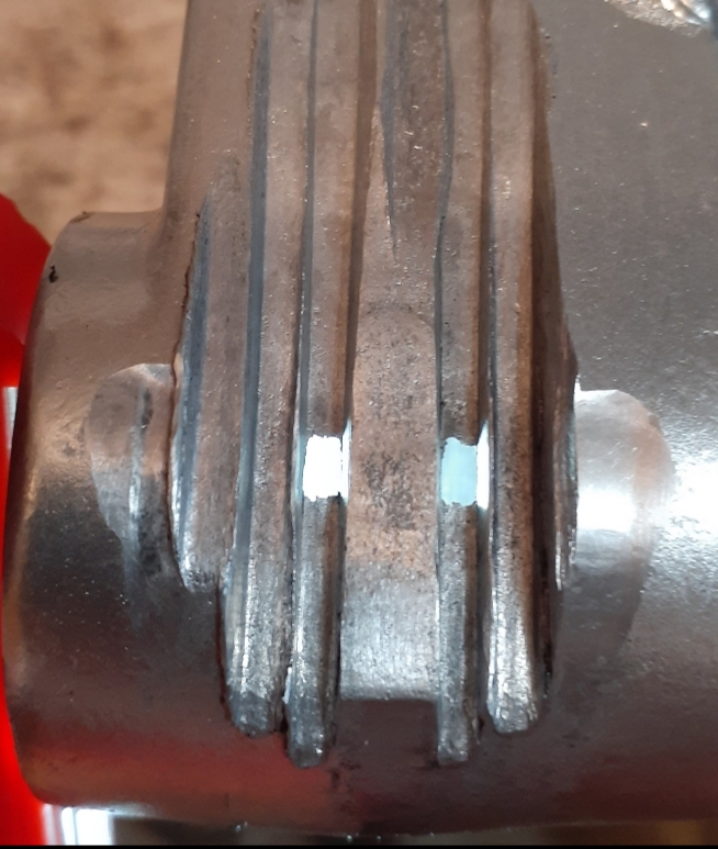

In short, the chain wore thru the swing arm and it looks like it's just at the cage of the bearings. If I knew a good welder here, I would attempt to see if it could be saved.
Now I know why the previous owner cleaned everything off but the crud on the swing arm. Lol. This bike is definitely a learning experience too. I'm really starting to get higgys post.
I did buy one off ebay but the seller had to refund my payment because he didnt realize he no longer had it. I think I found another one but I'm not going to believe until it's in my hands.

Into the cage for sure

Thats what happens when the chain is to loose, but that aint the worst Ive seen . I would not panic about that to much , make sure the chain is properly tensioned and fit a new chain slider ( snigger)to the swingarm and try not to think about it .
