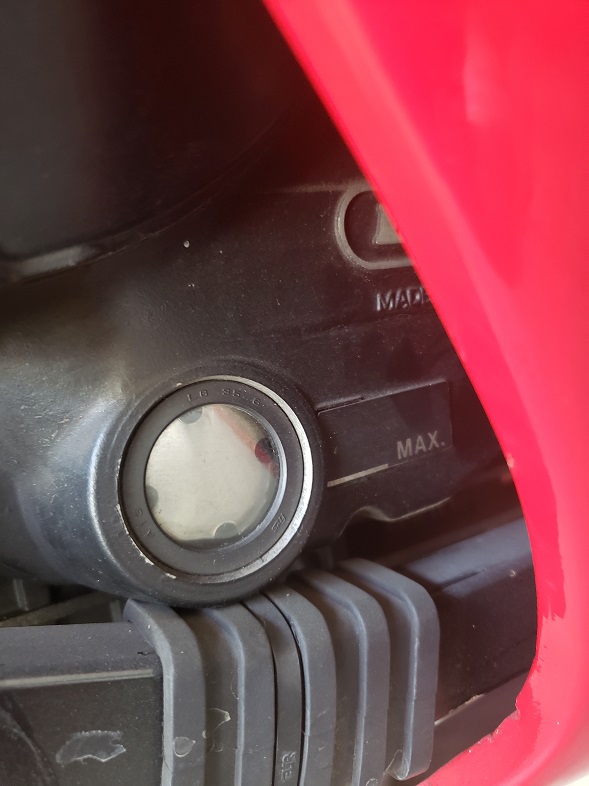

When you do your oil changes, are you putting in 3.5L of oil? I put in exactly that amount, which is the listed capacity in the owners manual, and it completely fills the view window when the bike is upright.
Here's a picture of the sight glass when on the side stand. There's no min level and the max is crazy low. Do your sight glasses look like this too?
The Viking
'91 907i.e. Paso
 Post subject: Re: Dumb question about oil level
PostPosted: Mon Apr 08, 2019 4:50 pm
Posts: 13
Location: Lakewood, CO
So I was talking to a friend of mine in the motorcycle industry. Apparently that max line is a sticker that was applied to bikes during this time period. It seems that a common complaint at the time was that the Ducs took a long time to warm up. The Italian solution was to drop the oil level...
The Viking
'91 907i.e. Paso
PostPosted: Tue Apr 09, 2019 9:03 am
I never put in the whole 3.5 litres. After draining the oil and changing the filter (filling the filter before attaching) I fill the oil until it is half way up the sight glass. After running the engine and letting it settle for a couple of minutes I top up until it is again half way up the sight glass (where it should be). This usually uses 3 Litres or very slightly more. On a normal change there is always some residual oil left in the engine. The only time it will take a full 3.5 litres is with a completely dry, say newly rebuilt, engine.
