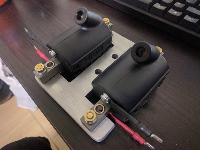

Dynatek DC10-1 coils, Magnecor KV85 wires, new NGK plugs - I did these all at once and had a aluminum bracket made up to fit the dynatek coils, WOW! What a difference, first time starting and I swear before my thumb had reached the bottom it had started and was idling smoothly.

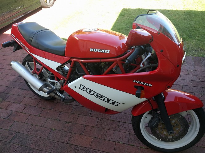

File comment: Coils on bracket with spade connector fitting I made up to keep original harness.
File comment: Single seat cowl fitted and useless mirrors removed.

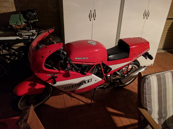

File comment: When I first got her home.
