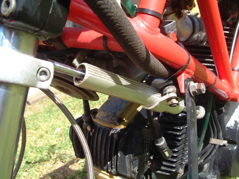

Posts: 65
 Post subject: Re: steering damper curious
PostPosted: Thu Nov 17, 2016 5:35 am
Well, that certainly looks like it works. A fine job of tucking it in there. The action won't be as linear as it would be mounted to the outside of the fork, but I'm not sure that matters that much. High speed wobbles are mostly while pointed straight, and not in a parking lot where you are testing the limits of your fork stops. That damper is certainly a lot cheaper than the Ohlins one I ended up with. Ohlins is nice stuff, but the price is bit too dear, even used. The one shown above was on my bike when I got it, but all of its damping had long since left, and it was simply an ornament. I tried to fit one from a 748, but never found a good way to mount it.

Funny enough the damper position in the last pic is very similar to the standard F1 damper position (mounted on the opposite side), ill try and post some pictures of the damper on the laguna..
