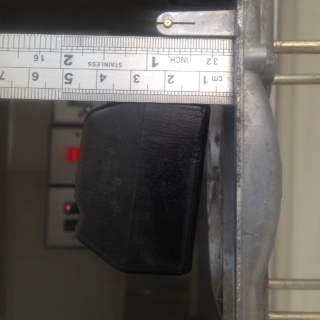

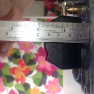

Thanks for that Derek. If you look at the two photos you can see my dilemma. The first one is as I discovered it. It looks miles out and with the angle of the float it's not actually easy to say exactly what the float height is.
The second one is after I have given the float tab an almighty bend down. This gets the top of the float nearer to horizontal and closer to 42mm. If the second photo is more like how it should be I am curious how the thing ever ran before. Ok I know I need the gasket on there as well (struggled to hold it flat as well as rule to get photos).
Am I on the right path with this now?

File comment: Quick tug to bring The float to a near horizontal position

File comment: As taken out- large float height even allowing for angles

generally when the float is level with the top you are close

Thanks Higgy that is what I need to hear. It makes more sense now. I have no idea how it ran before but if I have had to change the float height so much I suspect there may be other issues in the setup. I'm sure I will find your other carb posts most useful in the coming weeks.
