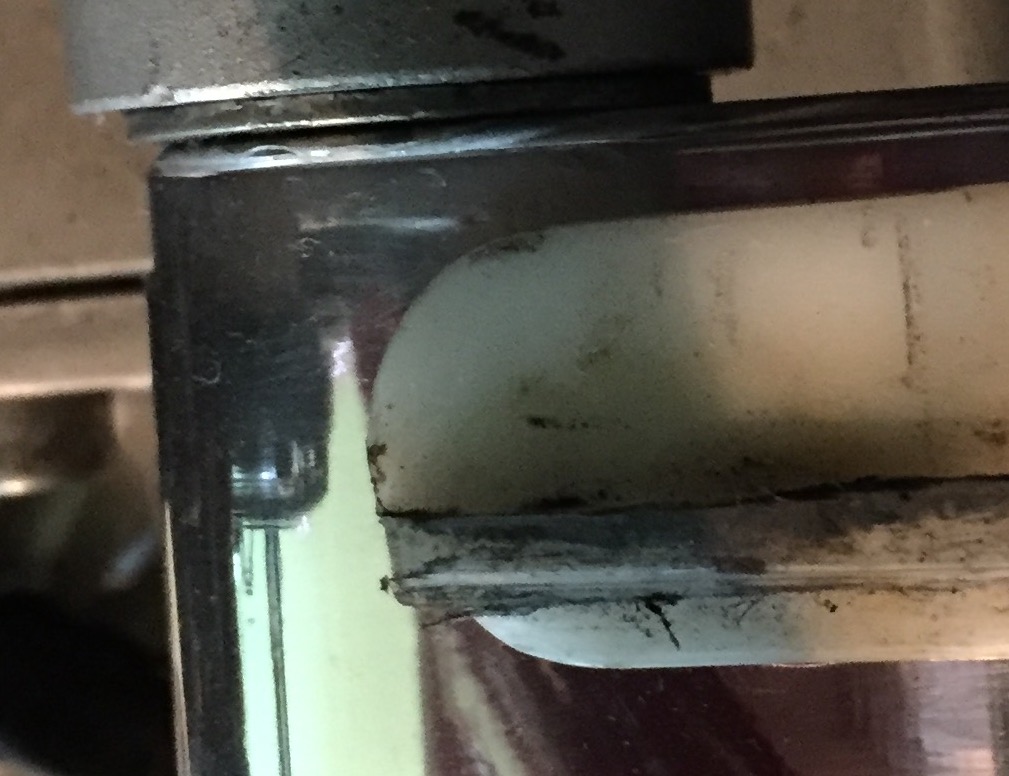

Here is a photo of the shim between my swing arm and the engine cases.

 Post subject: Re: Swingarm shim size on left hand side???? 1990 900 supers
PostPosted: Sat May 28, 2016 6:23 am
Posts: 69
Location: New Zealand
Thanks for that ... Threw it all in this morning ... Got .1mm as per manual so nice and snug
