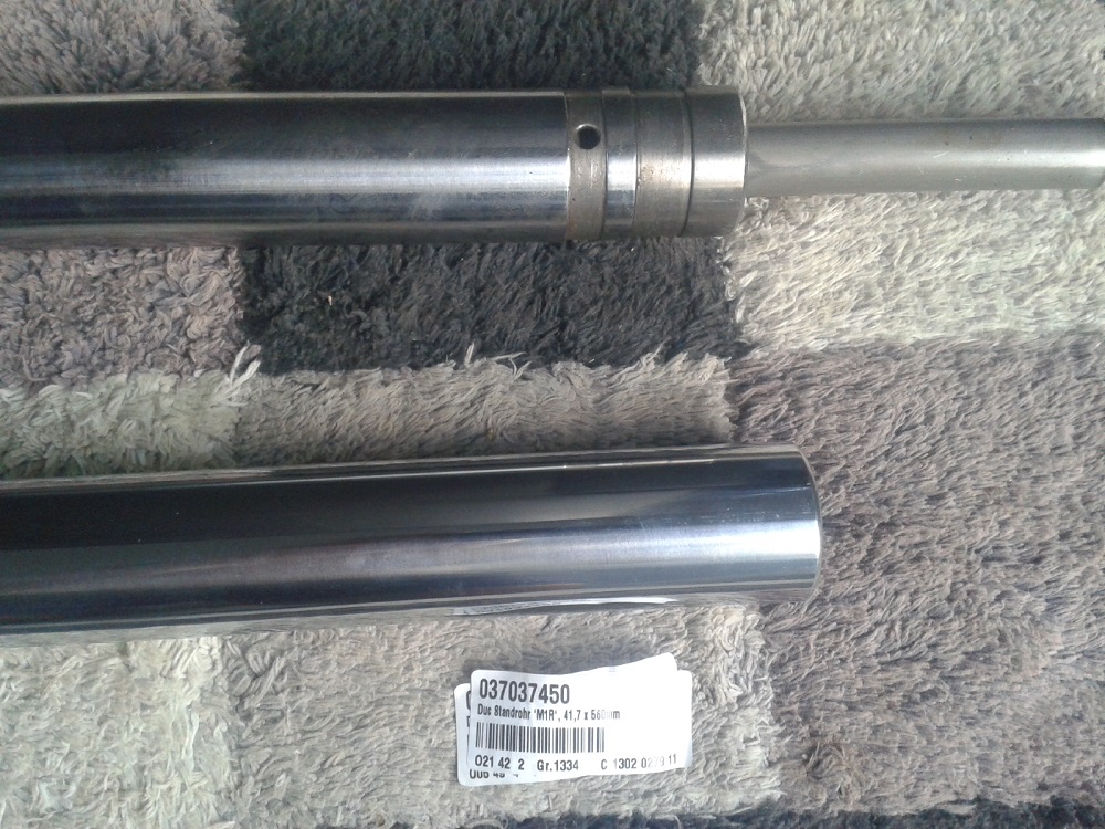

I just bought some replacement fork tubes from a reliable supplier in Germany , they are the correct part numbers , correct lengths & diameter , but at the bottom of each tube there is no step for the bush or hole drilled for the passage of oil .
My question is has any one else seen or fitted tubes like this or are they just wrong .

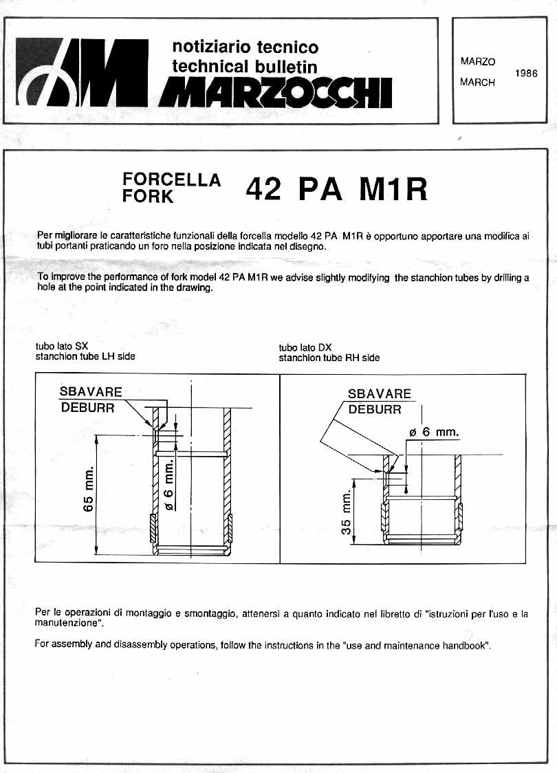

Are they for an earlier model M1R ? . I have seen a copy of a factory document that suggests drilling the oil passage holes .
Any thoughts ?

marzocchi_m1r_servicebulletin.jpg [67 KiB]
Not downloaded yet

Thanks for the reply's , I have some pictures of the new tubes & the old but just cant seen to get them downloaded .

Hopefully I can get these photos downloaded , original fork tube & new tube with part numbers.
looks like one of them worked !
As you can see they are totally different at the bottom end of the tube , anybody seen these before ?

Yeah, that doesn't look right. No place to mount the lower bushing our let the fluid pass through.

I have seen photos on the net of similar plain looking tubes , they where on a Ducati / Paso / M1R forum but I have no idea where !
It was these photos that made me think that there was a variation in the style of the tubes or maybe for a different model rather the reject them & return them to the supplier .
I will have to wait a bit & see if any more info comes to light before I think of what to do with them .
