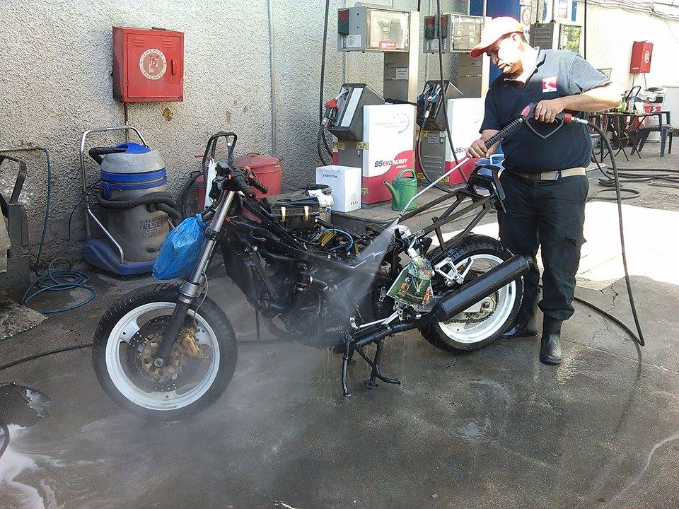

I removed as much stuff as I could and took the bike for professional cleaning. 24 years of dust and oil was gone. It needed some more manual work afterwards but the result is quite rewarding.
