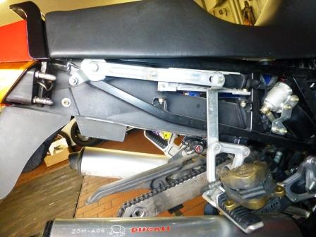

Hello
Does anyone know the manufacturer of the case holder?
The side panels were drilled.
not a nice variant
regards
Uwe

Krauser never made a system to suit a Paso / 907
Hepco & Becker have black tubular frames, not fitted like that
Could it be Givi? Here are some topics on luggage systems where also pics are posted. Try your luck there perhaps?

it`s not a GIVI and not a NonFango. Krauser did make a luggage rack for the Paso (for the K2 cases) but that`s not it either.
You don`t happen to have one case or a picture of one ?

Helllo
Thanks for answers
Sorry no more parts for this system.
Only what on the picture
And two holes in the side panel closed with 15mm rubbers.
I called the pre owner but he had also no information
Regards
uwe

Uwe, now looking closer at your little pic and surfing the internet I`d say that might be a mounting kit for a Krauser rack K1 or K2.
some pictures of Krauser mounting parts
http://www.ebay.de/itm/Krauser-K2-Halte ... 3ce085736a
http://www.ebay.de/itm/Halter-fuer-Krau ... 0868909808
http://www.ebay.de/itm/NEW-KRAUSER-K1-S ... 0544128035
http://www.ebay.de/itm/Krauser-K2-Trage ... 2a3bb620d4
http://www.fj1200-3cv.de/Download/KrauserK2.pdf

Hi Paso 750
Thanks for the information,links and the picture
I think it the Krauser system !!
The parts I build from and buy an Hepco Becker system because I still have 2 set HB suitcases.
