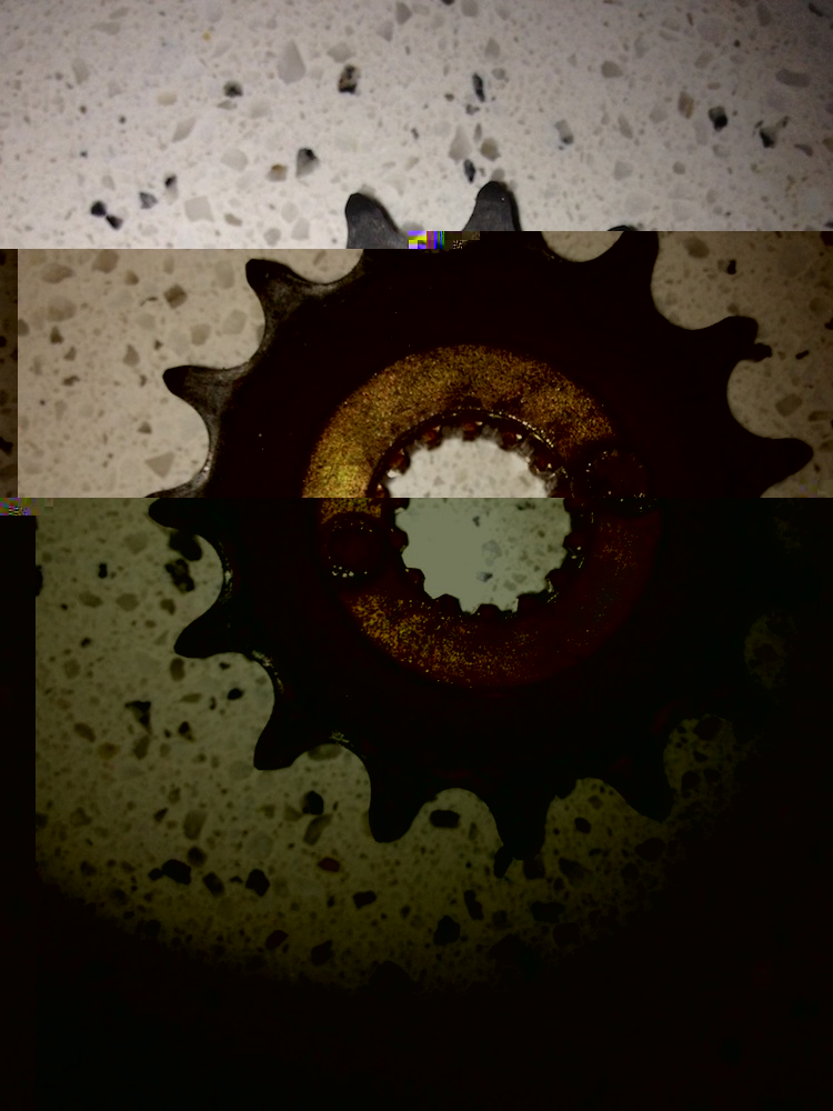

Took the old girl (750 sport) out for a spin today with my young nephew on the back, got 200m up the road when the bike lost drive from the main drive shaft, found the front sprocket (see photo attached) on the road about 50m away but nothing else, the sprocket looks okay, the splines dont seem to extend all the way from the front to the back, seems to be missing about 10mm of splines from the outer part of the sprocket, the splines closest to the engine look okay. There is a threaded hole in the middle of the drive shaft, its dirty and does'nt look like its had a screw in there for a while.
My question is this, does anyone have a photo of the front drive sprocket in situ so that i can tell what mine is supposed to look like, my parts manual seems to have 2 types of sprockets, none of which look like mine.
Secondly is there is supposed to be some sort of plate on the end of the drive shaft to hold the sprocket in place, if so i wonder if i could just make one up out of a heavy washer with a new bolt ?
Thanks in advance
Mick

Looks to me like the retaining ring is knackered .... lost its splines , and the whole plot just fell of the end of the shaft :) ..... AND you have the same kitchen bench top as me :D
The retaining ring ( different to yours as this is a 906 and the sprocket is on the other way round ) should have splines in its center which locate in a groove round the end of the shaft . When the retainer ring is fitted you slip it on to the shaft and then rotate it ( 1/2 a spline ) slightly in the groove and fit the cap screws , this stops the sprocket falling off . In your case there is no bolt fitted to the hole in the end of the shaft :)

Many Thanks Hamish and Paso 750, you were spot on Hamish, i have stripped the outer ring, wow thats one to check on your bikes guys, never thought that might happen. Guess i'll have to buy the sprocket and ring as they probably come as a pair, as for the washer maybe its set into the engine casing rather than floating free on the shaft, if i have lost it i should be able to buy all 3 you mentioned Paso 750 from the bolt shop and try them all till i find the one that fits.

I'm beginning to think that the schematic might be a bit misleading, i cant see any need for a washer there either, it also doesnt show the bearing and seal that sits in the gearbox housing behind the sprocket, maybe the washer in the schematic is actualy inside the gearbox behind the bearing and seal ?.
As for the retaining ring i have contacted a machine shop that do a lot of work on sidecar racers, they say they can use my old retaining ring and weld a sleeve inside it enabling me to bolt the sprocket on to the end of the driveshaft using the existing unused bolt hole. The schematic in the parts catalogue shows a similar set up see items 16 17 and 18.
Anyone want to jump in here and give me some for's or againsts please feel free !! i dont want the chain flying off at 120kmh :(

As for the retaining ring I would just get a new one and that`s it. Why instantly check for modifications. The retaining ring should be changed every time the sprocket is but it`s often not done.
