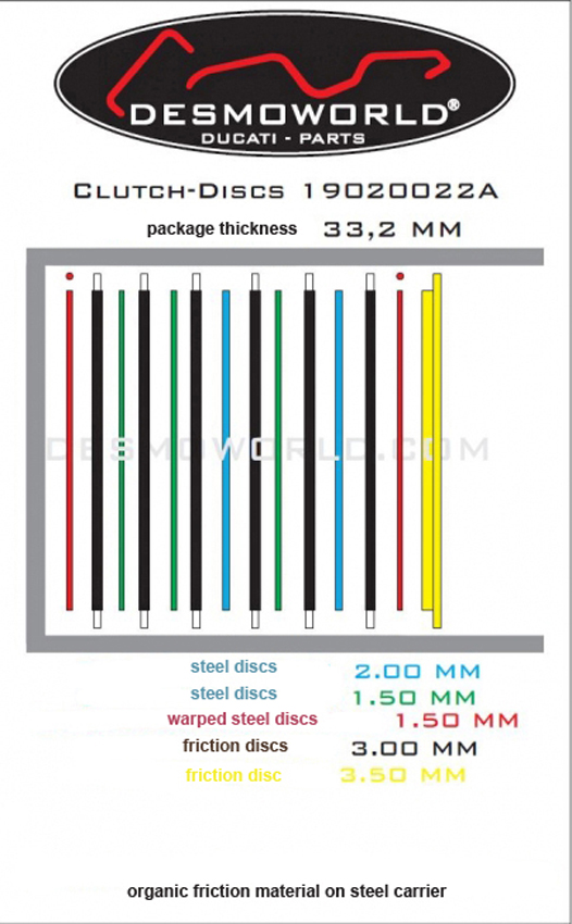

o Measure if the clutch discs are still above minimum thickness

P750 clutch disc order
19020022a Kopie.jpg [249.28 KiB]

 Post subject: Clutch Plates
PostPosted: Tue Oct 25, 2005 11:34 am
Posts: 1714
Location: Eastern Shore, MD
Clutch Plate Sequence:
viewtopic.php?t=490
viewtopic.php?t=412
Clutch Plate Pack order number:
190 200 22A (formerly 190 200 21A) or Surflex S2076 (or Surflex S1686 for the sintered clutch pack)
same for : 500 Pantah, 750 F1 -´88 (2.series), Montjuich ´86-´87, Laguna Seca ´87, 750 Sport ´88-´90, 750 SS ´91-´92, 900 SS ´89 -´90, 906 Paso ´89-´90, 750 Paso ´86-´89, 851 SB ´88, 888 Racing ´89
ADIGE clutch kits:
Please note these refer only to the friction pack. For the complete sets the best is to check the catalogue and find out the complete set code# against the friction pack code#.
According to their catalogue the dry clutch kits available are:
DU-45 (Elefant 650, Indiana, F3 , F1 Laguna Seca & Santa Monica)
DU-83 (Elefant 350, 750 Dakar, Explorer, Bifaro, 900)
DU-79 (Sport, Junior, Paso 750 & 906)
DU-56 (all/most of "dry clutch" Ducati from '91 onwards including the Tamburini* series)
DU-74 (851 & 888 and all Tamburini SP, SPS, R)
according to ADIGE:
DU-45 = organic friction Kit discs only (6disc+1 "tornito"** ) Steel disc support
DU-83 = organic friction Kit discs only (7disc+1 "tornito"** ) Steel disc support
DU-79 = same as DU-45
DU-56 = organic friction Kit discs only (7discs) Steel disc support
DU-74 - Syntered friction Kit discs only (8 disc) steel disc support.
*Tamburini = 748-916-996-998 in Strada & S versions
** Tornito = literally means machined on the lathe; I checked a couple of pictures on the web and it seems that these kits have 1 disc which is plain (no friction material)
The complete clutch kit (friction + steel discs) is: DU-81
