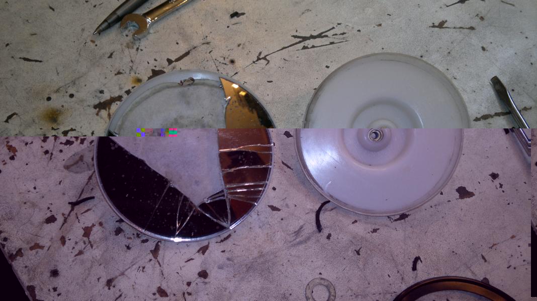

Both mirrors were broken.
15042012870.JPG [92.89 KiB]
Downloaded 476 times
The mirror-parts are unobtainable, exept the whole assembly.
Noone here in northern germany was able to supply these pulvinate mirror-glasses, that i could change them for myself.
On saturday i stumbled over a pair of mirrors by accident. 10€ each. The mirror-glass just one mil smaller in diameter than the original.
15042012875.JPG [72.37 KiB]
I swapped them today... :mrgreen:
