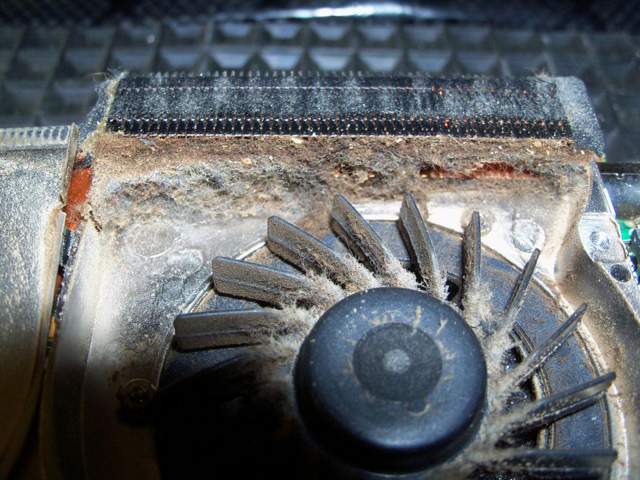

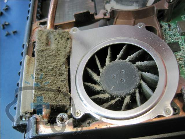

Except to HP none of the companies named manufacture their own harddrives. They are all from Seagate (Maxtor), Samsung, Western Digital, Toshiba, ExcelStore (Conner) etc
Normally the lifespan of a 2,5" harddrive wouldn`t be different than a standard 3,5" hdd from a PC.
3 in 3 years is not normal. The most common reason harddrives in laptops die faster is overheating. Another one can be shock & vibration depending on how you treat your laptop.
Other than in a PC there`s no proper air circulation in a laptop and the only thing cooling things down is a small fan. Of course this also sucks in dust and that causes the parts to heat up even more.
You`ll notice that if the laptop`s fan starts going off as soon as you start it up or if the bottom of it gets so hot you have to take it from your lap. In that case it needs to be opened and cleaned.
Storing important files on an external hardrive or on DVDs is always recommended.
