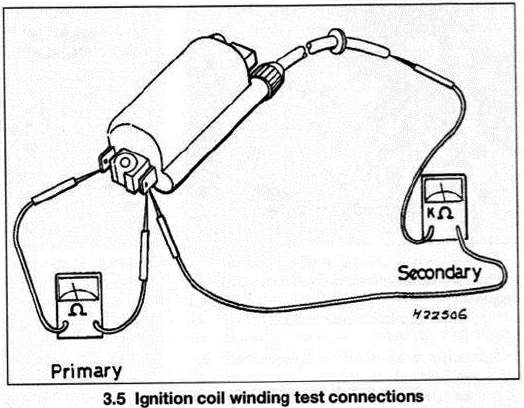

This leads me to a question for a non electrical type tho, how do I read the resistance to confirm that my ones are bad?
I have a multi meter and got a bit of an idea how it works but what plugs in where to get the readings??
Thanks, Rob.

Thanks for the diagram - makes perfect sense now!
