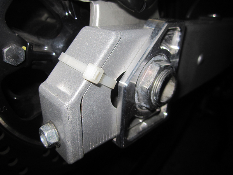

I wonder why the bolt broke in the first place. I'm guessing it was tightened a bit more after the axle nuts were or the axle came loose (or the conical spacer is installed the wrong way around?!). The bolts are M8x90mm btw.
Since I had read about this also in other forums I lockwired mine. Lockwiring the bolt may have been overdoing it considering the chain has to be checked and readjusted once in a while.

also a solution. :truck: Found on the ducati.ms forum.
