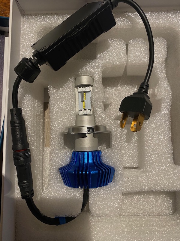

I too upgraded to a LED headlight. Most H4 replacement's will fit if you rearrange some of the cabling behind the headlight to clear the heatsink. In Australia I bought a Thunder (see attachment). At 2000 Lumens it's like riding in daylight. A word of caution though. If you are running the original voltage regulator you are running more of an unbalanced charging system.
A balanced charging system is when the manufacturer designs lets say 25 amp charging system and the bike uses 20 to 22 amps of it to run the bike and charge the battery. The regulator only needs to get rid of 3 or so amps, so it is happy. Now if you take that same bike and run led headlights now your making the regulator get rid of lets say 10 amps, now its working hard and getting hot. Although it seems like your doing your bike a favour by thinking it's going to charge your battery better your actually slowly killing your regulator.
I'm running a genuine Shindengen SH847 (beware of fakes, there are many of them). Purchased from http://roadstercycle.com/
Willo
Wannon
Australia
ps: You will probably have to aim the headlight lower to avoid blinding oncoming traffic. Easy enough done.
