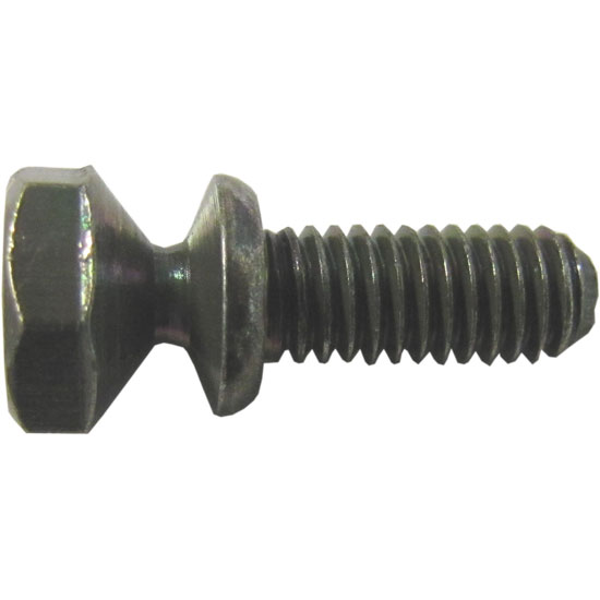

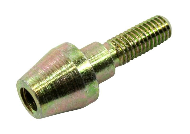

It's not stupid. Ducati and other bike manufacturers use them. It's an antitheft measure. There are different types. Some have a hex head that will break off once the bolt is tightened (bottom picture). The 907IE and several others used the conical bolt.
The are several ways to remove those bolts. Screwing another bolt into the conical bolt and countering it with a nut is unlikely to work. You should remove the triple clamp from the bike first. Then you can use a file/angle grinder or Dremel to create two flat areas so a fork spanner can be used to undo the bolts.
Or if that doesn't work you can screw in a hex bolt and weld that to the conical one.
Another option, which I guess won't work tho, is screw in a hex bolt with high strength Loctite. Maybe the Loctite is stronger than the torque of the conical bolt.

Mine screws are just like in that Gerhard's upper foto...... I know, that it is "securite" thing against bike stealers, but Ducati did it stupid way: Nowbody have time to open keylock underneath if try to steal bike fastly! If want to steal bike, then lift it fastly to van and later in carrage is enough time to derstoy such nuts some way. We shall see, what method i will use..... Anyway, stupid design and i never ever anymore put there such stupid nuts. Nylock's will be much better :thumbup: :lol:

#3 Easy out with a 1/4 Drive wratchet, gently applied pressure and they came right out. Weren't very tight to begin with. Replaced with socket head capscrew after repairing the switch.
