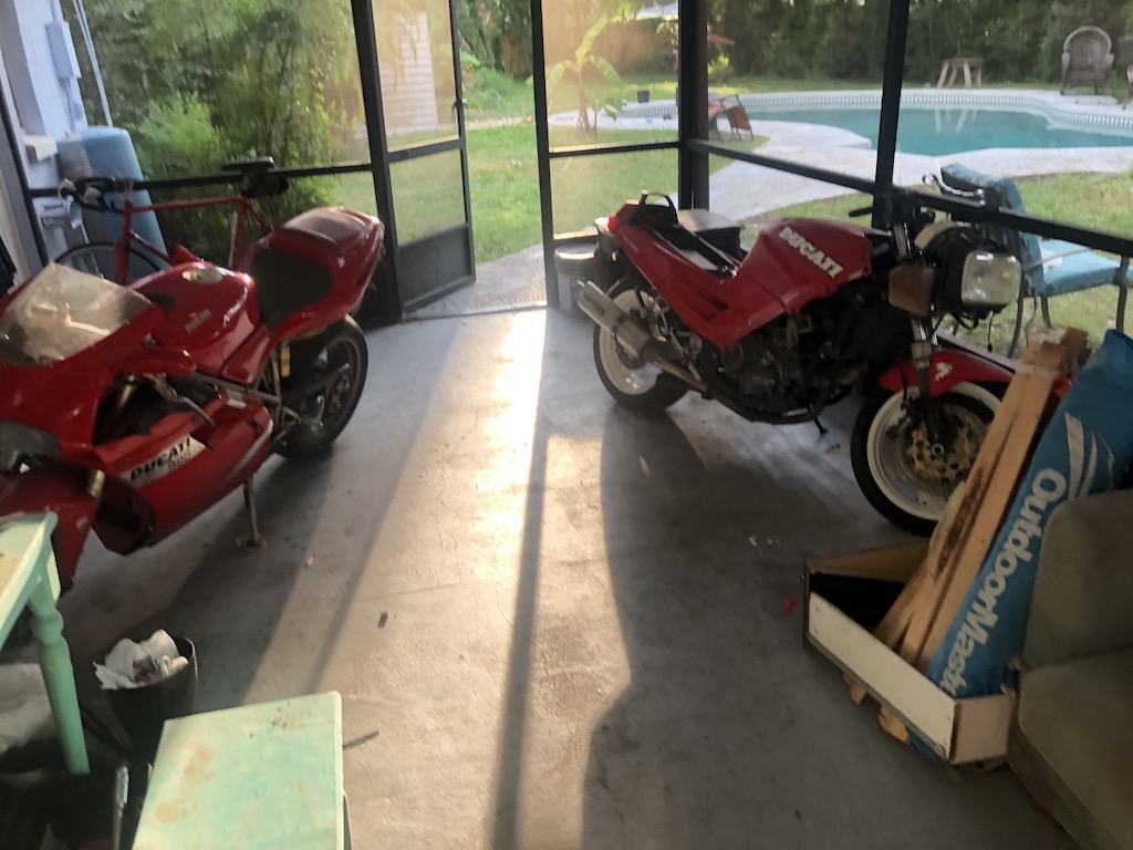

Thanks for the help paso750. Here are a few photos of the bike.
64876045686__3EF68960-1F59-4A60-A4CE-2FB568DA82AA.JPG [ 204.63 KiB | Viewed 43354 times ]
 Post subject: Re: $100 907ie
PostPosted: Sat Jul 31, 2021 10:05 am
It looks a bit rough but a good basis for a restoration. Finding the missing parts isn't a problem.
