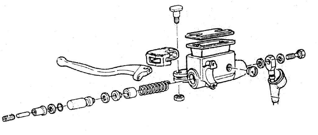

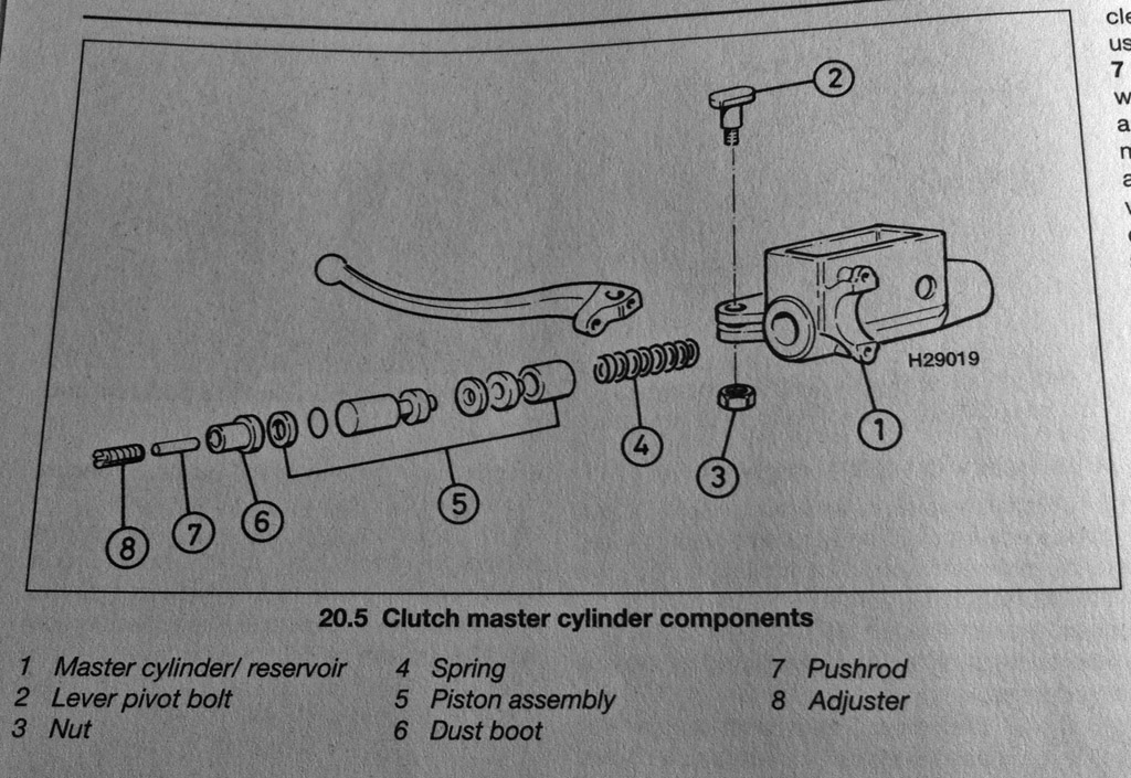

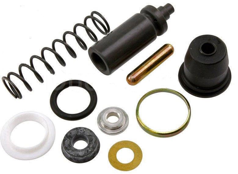

All, I recently lost all pressure on my clutch master cylinder, so my bike jumped forward when I changed into first gear. Luckily, I had the brake pulled:-) Anyway, after trying multiple bleeds and refills, I finally gave in and located a Brembo 98.5029.70 rebuild kit that contains all of the parts needed for the typical rebuild. I was able to partially remove the clutch cylinder from the handle bar (i'm not the most mechanically inclined person) and then proceeded to remove the old pieces, the spring, bolt o-ring, etc. While I was careful to remove everything without breaking it, I did use pliers to remove some of the parts. Unfortunately, I am now unable to figure out in what exact order the rebuild kit pieces go back in to the master cylinder. I printed out the old manual and workshop manual, BUT the info is not pictured clearly enough and it is also showing a piece not part of the actual master cylinder nor the rebuild kit. Specifically, I have all the new parts to replace the old parts but cant figure out in what order and how tog et them in there. It seems there is one crucial piece of order related to the larger rubber piece and some type of metal crush washer? I can provide pics as needed, but I really need help getting this sorted today or tomorrow. I need to ride the bike out of a storage building and back to my house. Everything else works:-( Thanks for any assistance.

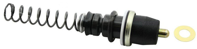

this shows the Ducati #000047226 repair kit and the order it`s installed (looks a little different compared to what the manuals show)
