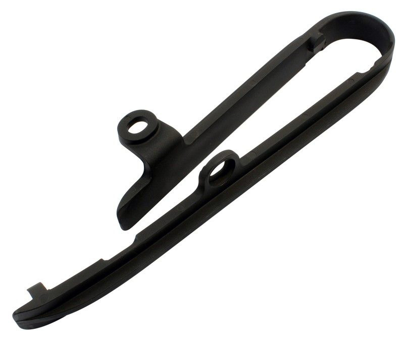

thanks for trying it out and the pictures! Wouldn`t it be better to use the lens head screw without the washers below just to increase the distance from the screw head to the chain ? You could use a very short metal tube to ensure the tightened screw doesn`t break out the plastic.
Are the centers of the chain sliders at the same position and how did you fixate the bottom part or did you shorten it like the original slider ?
The part number btw is #44710731A and fits also other model years of the Monster 696.

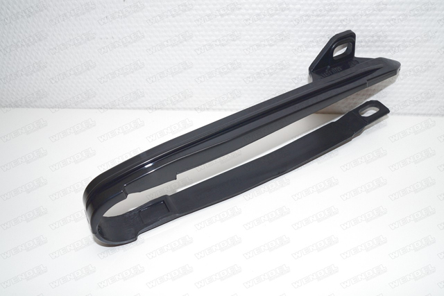

the swingarm chain slider of the early Aprilia RSV Mille might also be another option but it would require some modification as it becomes thicker in the middle.
Also it`s quite expensive.
However there might be others from other bikes that may be similar to ours.

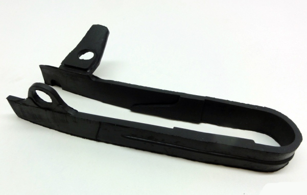

Honda MTX
