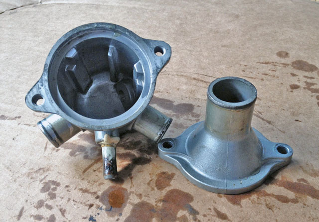

OK, so a bit of an update (partial)
Here is the stock thermostat (the right one) next to the Aprilia 1000 thermostat
and here is the space on the bike where the thermostat goes.
Since I could not find a graceful way of modifying it, I kept the stock one in. It works fine, and the coolant that came out of the bike was crystal green. I have fired it up and confirmed the stock thermostat works as it should.
I'll update with pictures of the 1098 thermostat, and the Aprilia Mana 850 thermostat. Nothing is plug an play, but I'm not giving up on finding an elegant solution.

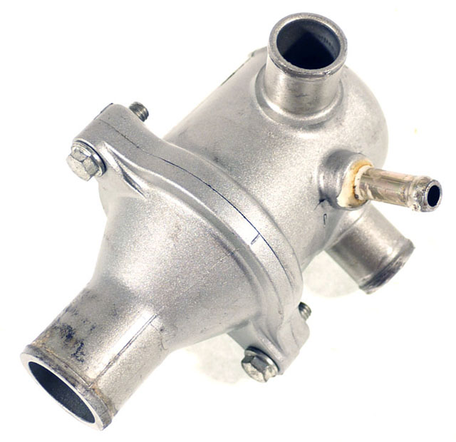

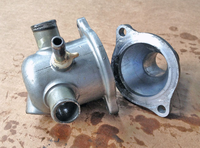

I don`t know if the hoses sizes are the same but did you see the one of the Hyosung GT 650 ?
Its problem of course is that hose nipple in the middle but seeing that the thermostat housing can be disassembled one could heat up the housing and pull the tube out (or cut it off) and if the housing was thick enough, tap the hole and insert a short screw with some thread sealant.
(That thread that can be seen inside the housing on the last picture is for a temperatur sensor)

PostPosted: Wed Nov 12, 2014 11:51 am
just got a reply from a seller of a Hyosung thermostat on ebay. The larger hose connection is 26,6mm outer diameter (21mm inner) and the two others are 19mm (14mm inner).
