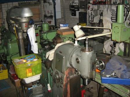

ST2 heads; indeed there is no provision for a tachodrive. this has to be machined. the protrusion in the casting of the head is still present.
I've a complete ST2 engine waiting and two sets of empty ST2 heads.
First set is ment to be cut open for measuring wallthickness of several areas at the valve guides and look for possibilities of twin spark. the second set is for realizing all this. the third set on the ST2 engine is a backup as the second set has to be scrapped.
first I have to complete my machine shop. :D
Bertus

yes Derek,
this is possible.
measure up the tachohole and the threaded hole of the tachoattachment.
you can also use the 900ss head to adjust the fixture to position the ST2 head correctly on the milling machine or lathe. access to a milling machine is in this case more convinient.
IMO some other forummembers have done this before. Finnpaso?
succes! :beer:
