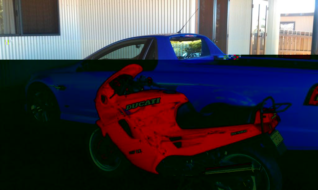

Thanks to those who have posted replies. I thought I would add a picture of the 907 and answer the questions too. Also a couple of things I forgot yesterday (CRAFT setting in?). And like all good things, more evolution too.
The 907 has a set of Staintune Mufflers with what looks like the original headers. Another funny one here. Where the 4 pipes of the headers converge, there is a nice plate welded in the gap. It catches all sorts of crap including the odd drop of oil. Makes you wonder? The bike also has a non standard chip in the ECU. No idea what make or version? It does disable the the ECU trimmer. Or maybe I should say the ECU trimmer doesn't do anything, which could possibly have been disabled by the Chip?
