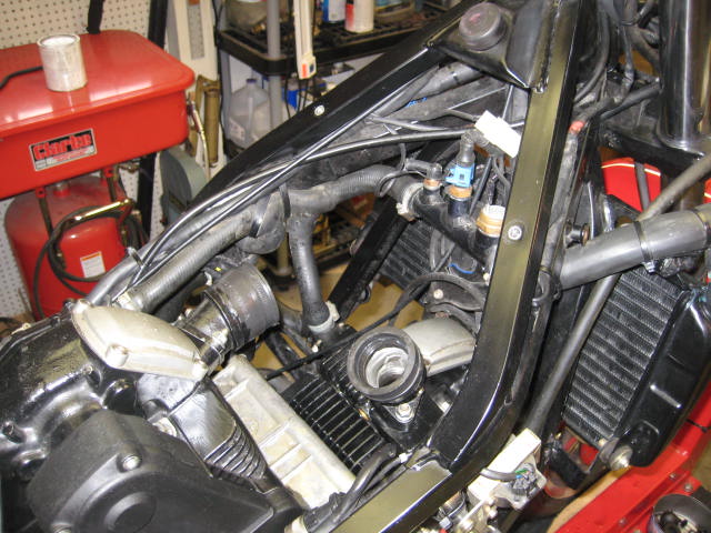

Here are some pics, one is from the top the other is from below. I hope that helps a bit.

The rubber disk should be there, I have no idea why you have a bolt and nut. The bolt head is obviously making hard contact with the tank (not good) based on the paint. This mount supports the tank, the side panels and rear bolts stabilize it. You can reference the Parts Catalogue available elsewhere on this website.
Regarding the cooling system the only thing I can add is the need to bleed air at the rear cylinder's water inlet (high point). There is a bolt that can be removed for that purpose.
It just occurred to me, I'e never lifted the rubber cup on my frame to see what is under it...could it be that yours is missing entirely?

I think you are missing the rubber bit and that someone has fitted a bolt to give correct space ( the post is threaded )
I also had to repair the tank where the tube mount thing is welded to the underside of the tank . I cut the tube right off , trimmed 2mm off the length , welded a ( about 100mm ) square bit of 2mm plate to the tank and refitted ( welded ) the tube mount back on , you can see the weld just under the front edge of the tank

If you havent fitted the top of the airbox correctly, this can also contact the tank and not allow it to seat properly.
But, i would suggest the bolt/mounting cushion is the main culprit. It if aint there, sloppy tank.

- Thanks for the photos, I'm definitely missing that rubber disk. I'll have to make or find a replacement for that.
