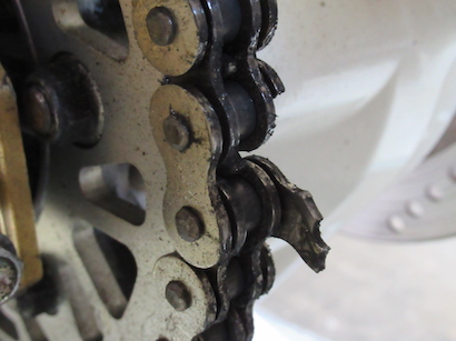

Just fitted new chain and sprockets, the old chain was broken partially. Had luck that I saw it just in time.
But now completely confused how the rear chain tension should be set :banghead:
1) The workshop manual says there should be a person sitting on rear part of the saddle, the owners manual says without a person on the machine
2) the text in the workshop manual mentions a rebound range of 15-20 mm; the figure shows a 15-20 mm distance between chain and swing arm, this fits better with the text in the in the owners manual; but it mentions a minimal distance of 15-20 mm, so 30, 40 or 50 mm would be OK too, I doubt
So what is the correct procedure?
File comment: broken chain

I hope you didnt get the same chain , looks light weight ,like maybe for a MX bike. Could be why it broke , also could be over tightening chain.
The chain tension changes as the rear suspension moves up and down . The chain is at its tightest when the output shaft (with front sprocket on it ) the swing arm pivot ant the rear axle are in allignment . At this point the chain should have minimal slack but not be pulled tight . If you can be bothered you could use a ratchet tie down and pull the suspension down till these pivots are alligned and set the chain tension to have next to no slack ( but not tight or stretched ) and then release the suspension and see how much slack you now have . This is your correct chain slack ....usually about 20- 25mm .
