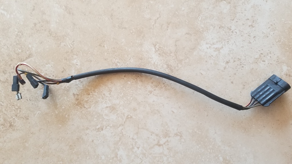

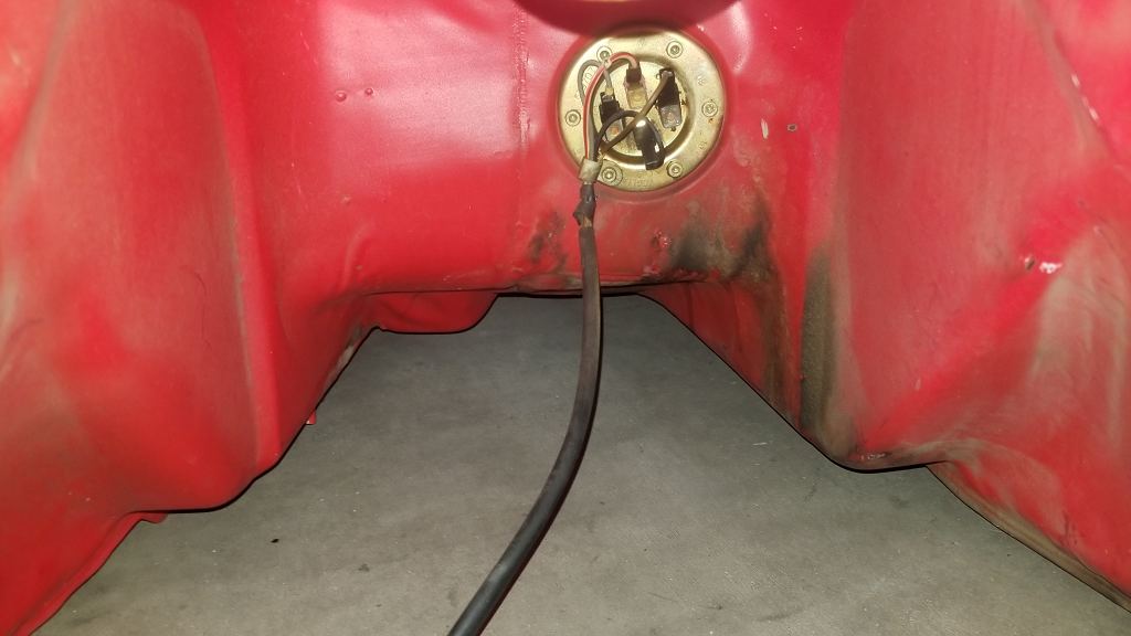

File comment: This is the harness in question. The sheath and the exposed wires are stiff as a board.

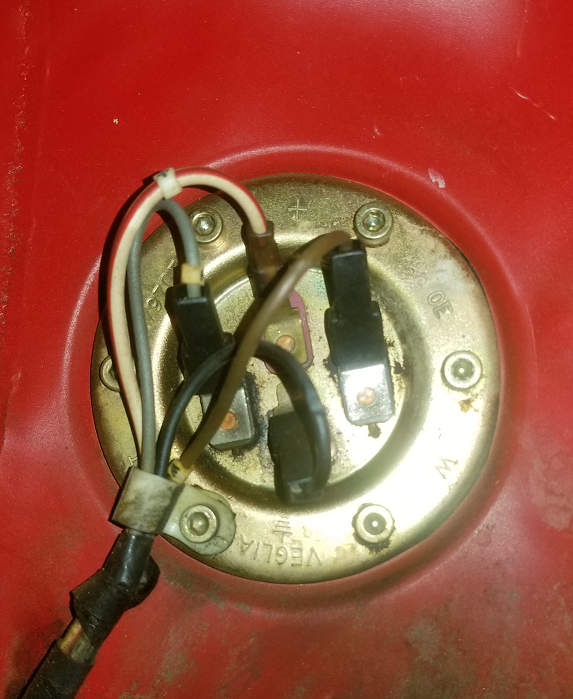

File comment: Too bad it had no heat shielding.

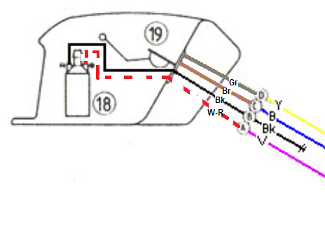

File comment: The wire colors are not all the same as shown in the color wire diagram. All except the black ground wire change color at the 4 wire plug. All but the ground wire have tiny plastic lettered identification labels around them. These can be moved to the new wires.
V --> W/R (White with Red stripe) = + 12V, label +
Bk --> Bk = - Ground, no label
B ---> Br = Fuel level sensor, label W
Y ---> Gr = Reserve fuel level sensor, label T
File comment: My crude revision of the color wire diagram to show the change in wire colors in this harness section

I built a new harness with these parts from eBay.
16 AWG GXL high temperature automotive wire in colors to match what is shown in the wiring diagram rather than what I found. So, Violet for +12V, Black for ground, Blue for fuel level sensor, Yellow for reserve fuel level.
One 4 Pin Delphi Weather Pack Sealed Connector Kit 14-18 AWG
Three 1/4" insulated male spade connectors (from my own supply)
One 4.8 mm insulated male connector (sold in pack of 20)
One insulated metallic heat shield sleeve 1/2" (sold as 3 ft strip)
I connected the other half of the Weather pack connector to the main harness. The final product worked well, but it did not solve the problem. Rechecking everything, one of the relays was not reliable I cleaned the contacts and it's good for now, although I need to replace the two FI relays.
