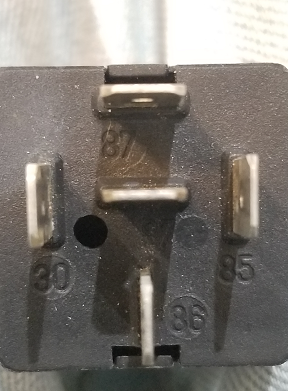

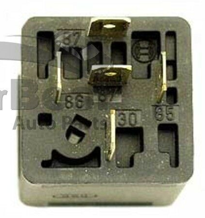

For example, here is a type B double output relay. These are often called double make and break. If you look at the bottom pin configuration, you would need to swap the wires to pins 30 and 86
Bosch Automotive 0332019151 Relay is type B
File comment: Ducati Relay. Type A. Note position of pins 30 and 86

I haven't pulled them out to have a look but the diagram shows 4 pin on/off relays, not changeover. There is no pin 87a on the diagram. If the ones fitted to the bike have it it is redundant.
When I need to replace the relays, if I need to I'll quite happily swap round the socket terminals. It is very easy to do and if you damage one new terminals are readily available.

Right, there is no 87A. The relays have two 87 outputs, Normally Open. All 5 pins are wired. Sure, I could swap wire 30 for 86 on the plug and get a Type B 5 pin dual output and be done with it. That looks like the easiest option at the moment with no 5 pn Type A relays available, as far as I can see. Oh, well. I appreciate the input.
Update: I opened up the relays again and cleaned the contacts a bit more (using a business card). Everything works reliably now. Bike starts and runs fine. Woohooh!
