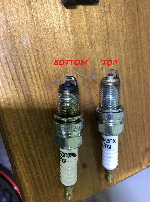

I didn't get single cylinder operation (maybe I didn't ride it enough) but I noticed the same thing as before when I removed the spark plugs for inspection.
Top cylinder spark plug is white and too lean and bottom is black and wet.
I am starting to think that the reason the bottom cylinder stops working is due to fouled spark plug.

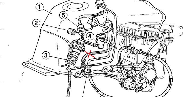

I also removed the fuel filter precautionary to replace it from inside the tank only to find out the anti-vapor valve to be disconnected. I don't know if this could be the source of the problem though.

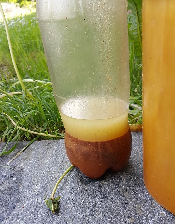

Ok... some time ago my dad bought me a "just serviced in excellent condition" SS750S (the poor's man one) sold to him by an acquaintance who had a nice garage and "he knew VERY well his way around engines since he was a professional"
Anyway 3 months later I manage to find the time to collect the bike from the garage and on my way home it starts to splutter over 4K and ultimately one of the cilinders dies a mile from home.
I was quite annoyed and I blamed the well known Ducati reliability; my dad Is aware i know my way around the V2s , but of course "you are not a professional, you know nothing...they guy said that splutters if the fuel is low in the tank...."
So , just to give him credit, I add 10liters and it gets worse...
I did not have time so I left the bike in the garage for 3 months , in the meantime I studied all the Injection system , the wiring, I get on ebay very very cheaply a full kit (coils, a TPS , Oil T sensor, ECU, Injectors, Leads, plugs and few other bits and pieces so that when I get the time I have all I need to fix the little 750.
I finally find the time and as soon as I look in the tank I immediatly see something I dont like.... I start taking out the fuel and I I find.... shit, literally...
Pump, fuel sender, all was clogged. the vent hoses from the fuel cap to the tank were missing and the connections inside bloked by rust and muck, I am not sure how the fuel did not go out (it if did it would have been a very nice big ball of fire...) inside the tank all hoses were bloated and the pump mesh filter was full of muck.
I disassembled & cleaned everything, 2 hours later it started perfectly...
I am still at a loss, how is possible the thing could run with all that water and mud... plus, the injectors are in series.. why was it running with one only? I dont get it.
Now the bike is fine, I hade to refurbish the tank and I might need a new TPS, or just some tuning (has a small flat spot at 1/3 of throttle at 3500RPMs)
Thank got it was fully bloody serviced... :banghead: :banghead:
This little story just to underline the fact that often we dismiss the simple things...

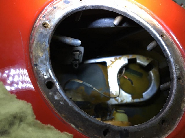

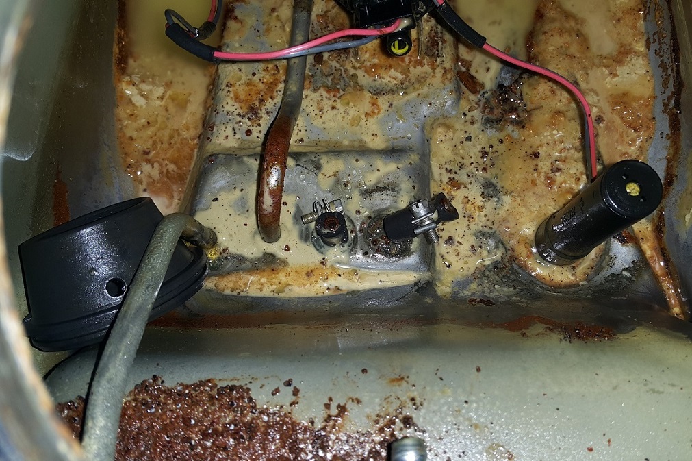

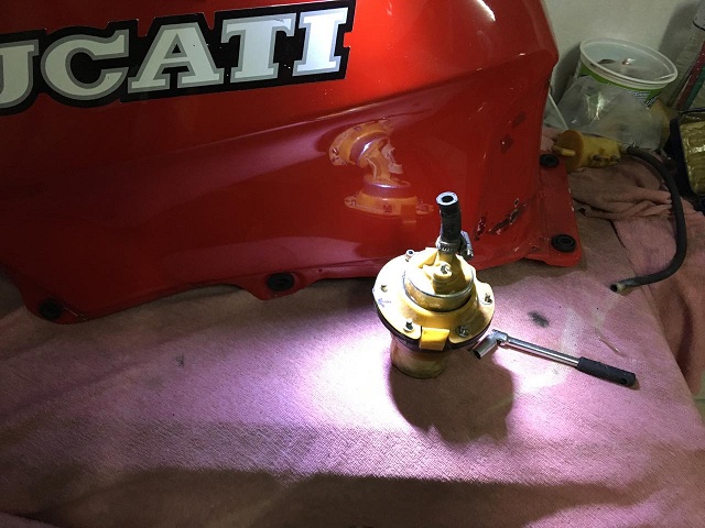

Here are pictures of the tank and the muck I too off, the bottle was a 1.5L just to give the idea of the shit that was inside
