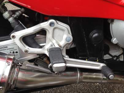

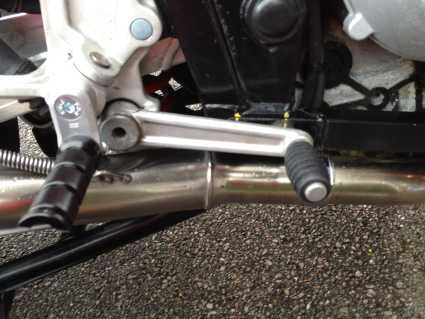

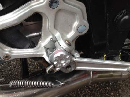

Bought some adjustable foot rest from M&P accessories they were quite expensive but well made ( German)
I have detailed how I fitted them each picture shows the stages of dis and re assembly
You need circlip pliers to release the original footrest pin and need to keep the spring to use on the new assembly
