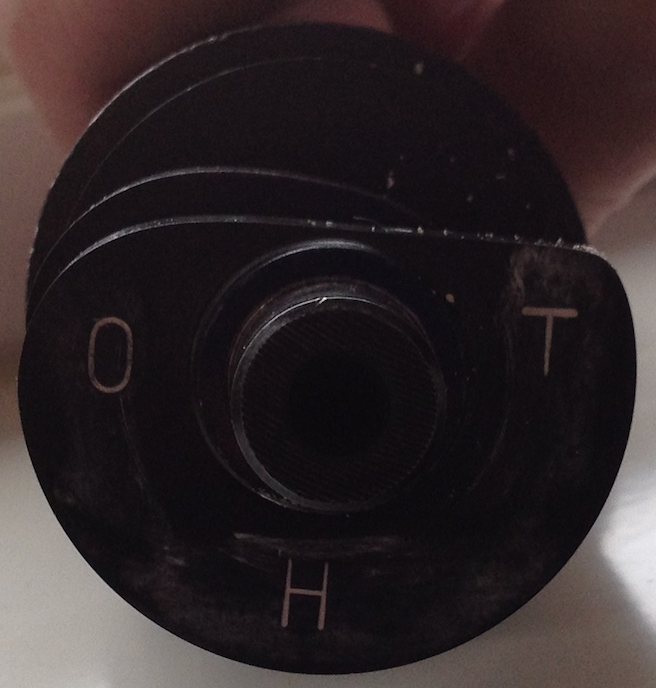

if not ST2 cams 900SSie cams would also be an option but they are also rare.
However remove the left camshaft/bearing cover and check what`s printed on the side of the cam. If it`s the same as a 900SS cam it`ll be VHT. (OHT on the horizontal cylinder)
I have a set of used ones you can have.
Not sure that 900SS and Monster cams are really identical. That might depend on model year. According to Brad Black`s site 900SS cams are marked OHT/VHT, Monster cams OR/VR.

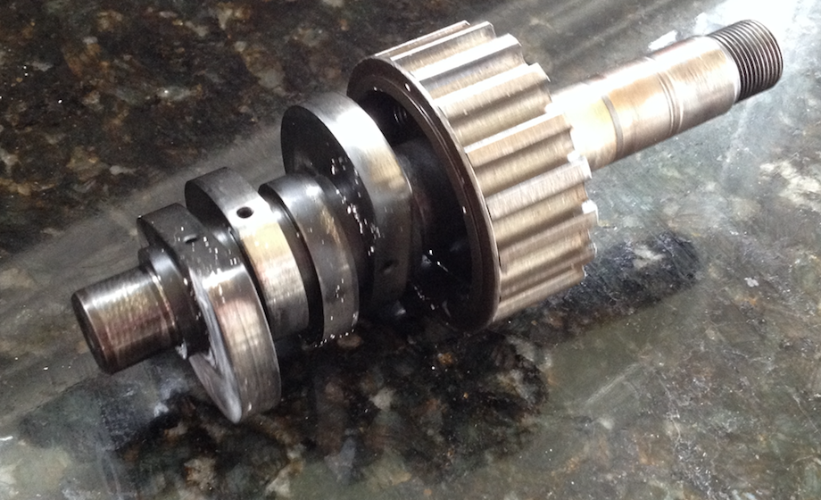

Hi guys, thanks for all the info. I took the cam and the pulley to a machine shop and they said it's not worth fixing. Both parts are worn badly. Thanks for the advice McTool. Maybe if we were in New Zealand some Kiwi guy could get 'er done. Paso 750 - I'll take up your kind offer. Although I need a pulley as well, if you have one. If not, I could source one from here, perhaps. As you can see in one the photos, the pulley goes all the way to near the cam lobes and is still sloppy. I'm guessing it's not supposed to go that far. Let me know how I can send you $$$ for postage and the beer fund account. Thanks a lot, good on ya.

I aint convinced , if a picture is worth a thousand words then holding it in your hand has to be worth a thousand pictures ,( you can use that if you want :D ). There is supposed to be a spacer , a bearing and a washer on that camshaft before the pulley goes on , and from memory the pulley is not that tight a fit on the camshaft ( don't tell Gilbert :lol: ) , like you can pull it off with your hand. The cam on the front cylinder also has the gear to drive the tacho and any spacers may be different sizes to allow for this , so make sure you have them assembled correctly , also I think ( not sure ) that there is a circlip ( just a piece of steel wire formed into a circle ... not the type with holes in the ends for circlip pliers ) that fits into a groove on the cam shaft which would stop the bearing , spacer , tacho gear and washer from sliding on to far , there is one on the cam drive shaft at the base of the Vee behind both drive pulleys . Sorry if Ive got this wrong but I just cant figure out how the shaft diameter and the pulley bore could wear so Im thinking by being sloppy you are referring to excessive end float. If there was enough movement between the pulley and shaft to cause significant wear Im pretty sure it would flog out the key way and shear the key way before wearing the shaft / bore to the point that it was unserviceable.

hey McTool the shaft is worn down quite a bit the pulley is very sloppy on the shaft where it is the correct diameter the bike still ran but made some wiggy sounds down there with the bagged keyway in you can move the pulley back and forth nearly one tooht of the pulley

Ah well sounds like your right to be looking for another cam , maybe a good opportunity to get some adjustable cam pulleys and give the ole girl a tweek . You still could have the cam metal sprayed and reground to size , and refit the key to the camshaft using Loctite quickmetal ( or similar )to fill the key way, and remove excess so when hard the new pulley can slide on , because with adjustable pulleys the key way position doesn't need to be spot on and then just degree in the cam to match the other pot. Im thinkin that maybe fixing one cam may be cheaper than buying a pair ( most cams would come in pairs ??? ) :)

Monster cams VR/OR are from small valve/750 heads, do not buy these.
I`d buy SSie for a bit more go.
