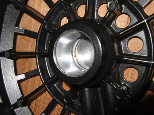

 Post subject: Re: Aftermarket clutch slave cylinders
PostPosted: Sat Jun 20, 2015 5:53 pm
