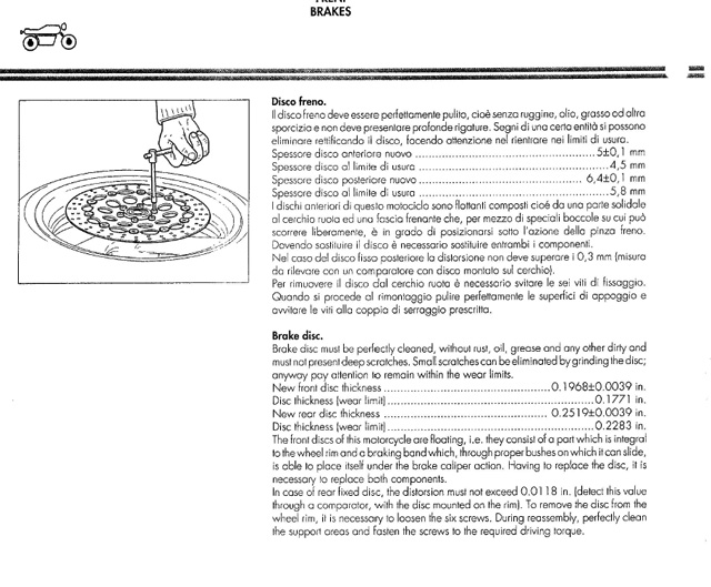

Quick question: According to my manual "new rotors" should measure 0.196-something and the wear limit is 0.177-something. What are do your rotors measure?
The brembos I put on my bike a while back have some pitting in them and I have a new/used set of OEM rotors I'd like to bolt up. The new/used ones measure 0.1556 and the ones on the bike measure 0.1554 and my old warped ones on the shelf measure 0.1554. I was thinkin "woa!" all of these are beyond the wear limit??! Thanks.

just have a look at the wsm ;)

Yup thanks, I have the manual as mentioned in my first post. Im looking for some actual measures.

new discs have 5mm and 4.5mm is minimum. You find that info also in every brake rotor manufacturers catalogs. The min. thickness is also stamped into the brake rotor. You won`t find any other info than that ;)

strange that even the Brembo catalog says 5mm

I spoke to Ian Gowanloch about the thicknesses of the 320mm rotors. He has a complete set on hand, and was positive they were between 3.5mm - 4mm. The one's he has are genuine Brembo disks. His opinion of the OEM (apparently they were Japanese Nissin, labelled as Brembo?) rotors was, umm, bad. He suggested if the bike still had the OEM rotors, throw them away are replace them with the new Brembo units quickly!
