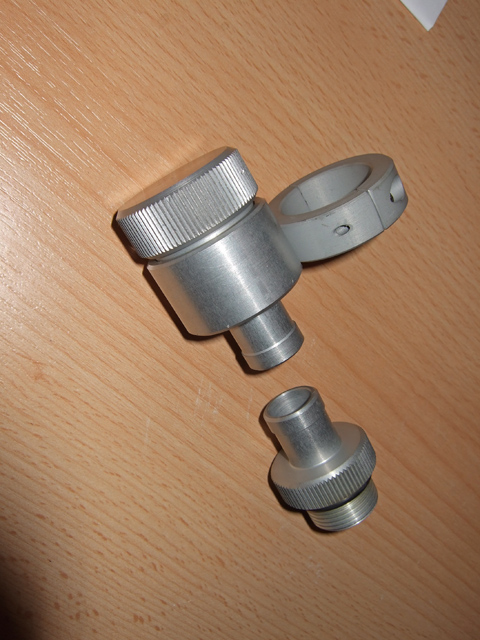

I found this for a 851/888 once. Not a bad idea but the problem on a Paso would be where to mount it to. :truck:

Thanks for that. Good idea. I'll speak to a mate of mine who has a lathe and is a very good technical bodger.

I can take the dimensions if you`re interested.

If you could that would be a great help. Could you take another photo of the O ring part of the adapter (where it fits into the casing)? I suppose there may even be a market for them, especially if they can be used on other Ducs of that era.

here you go
https://app.box.com/s/kohcxdnssrfnyywofb8q4289mqehizfy
Let me know if there`s anything missing. I make my drawings in Powerpoint as I`m faster in using it as a drawing program :roll: As a consequence small details as chamfered edges aren`t shown. Therefore I added more pictures. My Powerpoint drawings are just for the dimensions.
I`d hollow the cap out to make it lighter.

These are a lot more detailed than I was expecting. I will give them to my mate to see what he can do.
Failing that, I have a friend who owns an engineering works and has CNC machines. Unfortunately he is in South Africa, but will send them to him as well.

K. you should verify if and where you can position it on the Paso and design a specific mounting bracket.
(I forgot to mention the height of that bracket in the file. It`s 12mm but totally unrelevant for a Paso)
