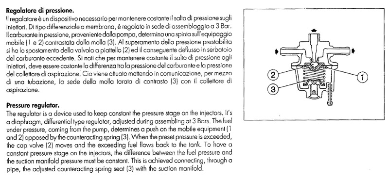

Thanks for the replies just a question there is a small pipe routed from the regulator to the the intake what is its purpose, only aftermarket regulators I have seen haven't got this outlet and have only a supply and return. Thanks again re Alistair :thumbup:
 Post subject: Re: fuel pressure regulator best place to buy in UK
PostPosted: Mon Mar 02, 2015 9:19 pm
from the wsm

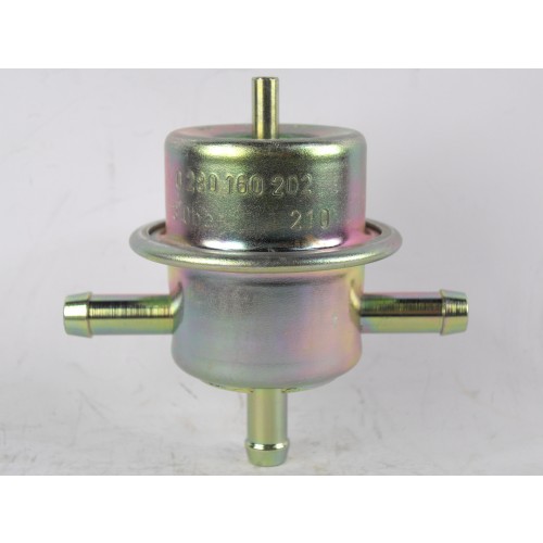

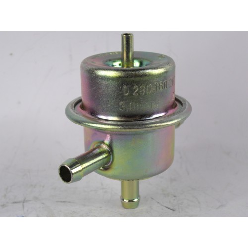

what I found:
Bosch 0280160202
(It should be verified that the hose connections are the same to be sure this is not a dual outlet or whatever! So this is just a lead to pursue. Connectors are for 8mm fuel lines)
reference:

http://www.bowerspartsonline.co.uk/bosc ... 0280160202
PostPosted: Tue Mar 03, 2015 1:07 pm

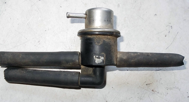

another option may be the fpr of a Volvo 850/S70/V70 which is 3bar as well.
This would require the housing, too.
I`m sure there are many others that could be used/adapted.
Of course the original part is still available but it has its price.

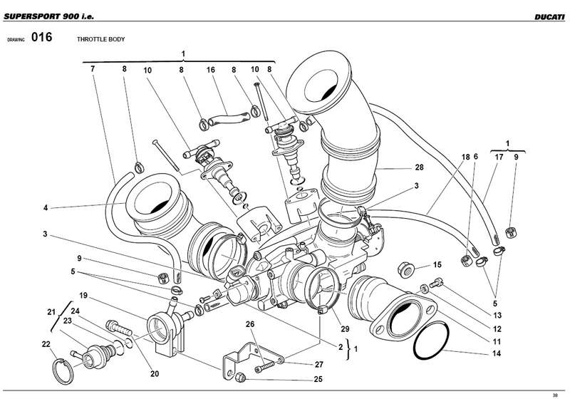

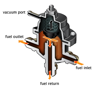

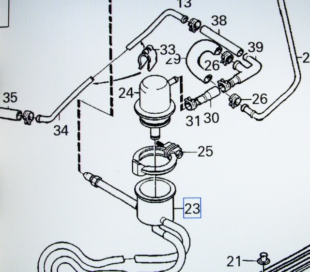

PostPosted: Tue Mar 10, 2015 3:02 pm
why didn`t anyone point out that the picture in the wsm actually shows the wrong kind of fpr? It shows one with an IN, RETURN and OUT (+ vacuum) hence a fpr that would be positioned before the injectors.
I was looking at the parts catalogue of a 900SSie and noticed the fpr was actually behind the injectors hence has only an IN and RETURN (+ vacuum) and that it is the same on the 907ie.
It is 3 bar as well. So it would be a suitable option. The fpr sits in a housing (830.1.091.2A - http://www.desmoduck.com/search.php?par ... 0.1.091.2A) other than i.e. on the ST2 where it`s in the whole tank assembly where the fuel pump and filter is.
http://www.competitionsystems.co.uk/product.php?id=80
http://www.competitionsystems.co.uk/product.php?id=79
or cheaper
http://atspeedracing.co.uk/products/ind ... cts_id=360
The last two posts are still an option I think but one would have to reroute the fuel hoses a bit and block the exit of the second injector so that would only be a last resort solution.
