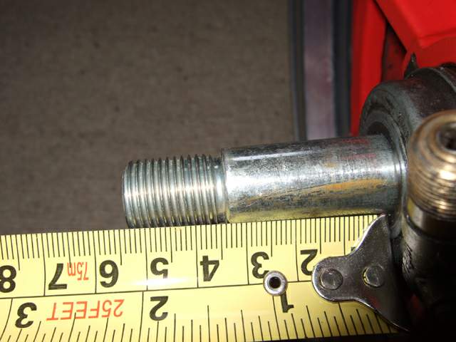

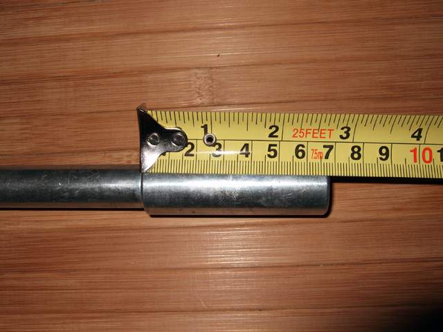

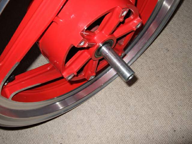

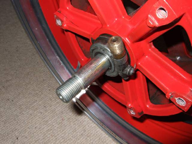

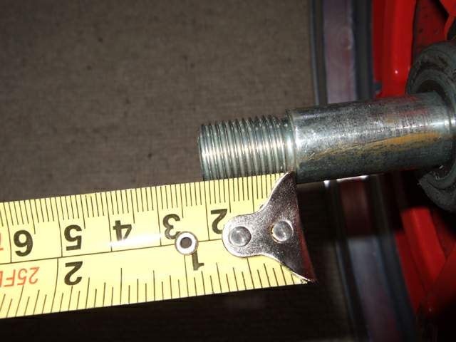

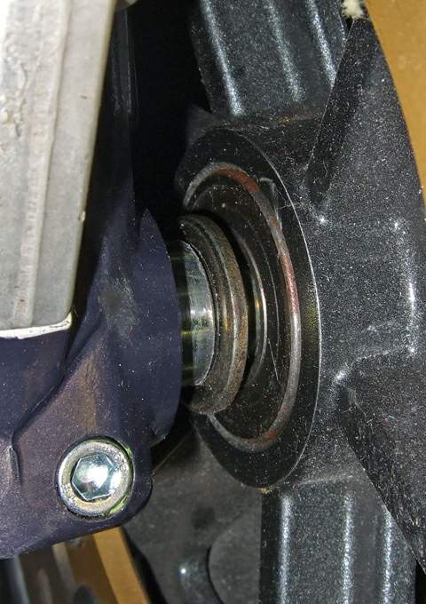

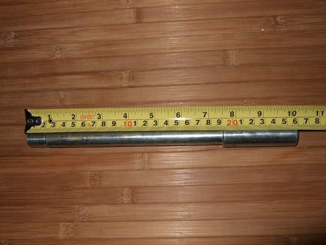

This doesn`t really answer any question but I took a new axle, rim and speedometer drive and checked some dimensions. This is of course a 16" Oscam rim with an according speedometer drive.
W/o the washer on the right the axle protrudes about 2mm more than the fork leg is wide. The thread is only 20mm long and protruding part w/o thread is ca 34mm which means that the hole in the left fork leg should be more than 34mm deep before the thread begins.
If it was less the end of the thread on the axle would touch the slider tube meaning there would be axial play and need of that washer, right?

I don`t think so. The thicker part of the axle is 22mm which means that the step is 2.5mm high (17mm axle). The inner race of the bearing is about the same height.

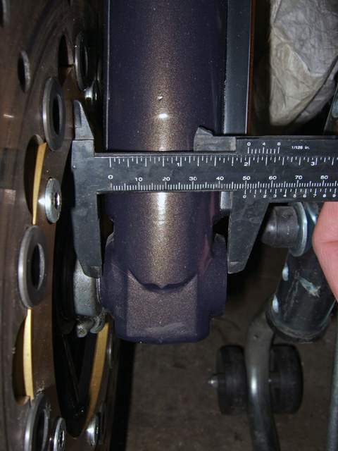

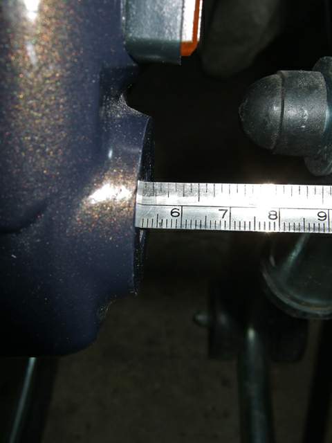

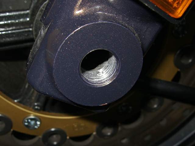

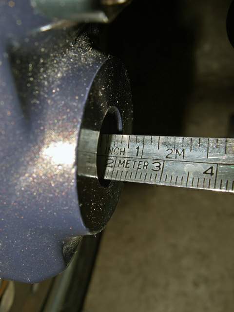

this whole story made me curious. I didn`t want to remove the wheel so I just pulled out the axle far enough to measure the fork leg.
I measure a width of 53mm. As I had posted last time the axle protrudes 54mm on the left side of the rim.
The thread in the fork is 20mm wide just like the one on the axle which isn`t really relevant.
More important is that the step where the diameter is reduced to the thread is about 23mm wide which means that the larger diameter unthreaded part is 30mm wide.
The unthreaded part of the axle measures 34mm (last post). Based on these numbers the consequence is that even if the axle was screwed in until it bottoms out there`s still a gap of 4mm.
It must be less than that as the washer is 3mm and the shim between speedometer drive and fork is 1mm (the 907ie doesn`t have that) but I`ll give that to my not very precise measuring.
However, if I haven`t made any thinking mistake this for me proves that on the P750 & 906 you need that washer or the wheel won`t sit tight.
