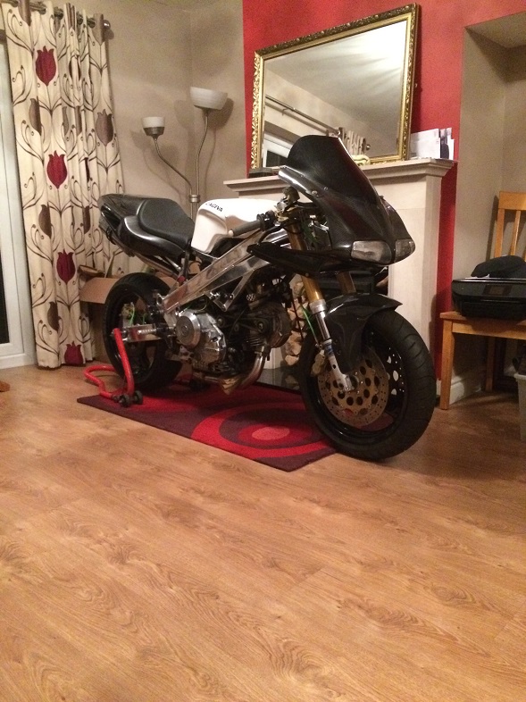

I've got a long-standing project bike (love/hate affair) it's a Spondon framed Ducati 906 paso.
I'll post a pic, so it will give everyone an idea of what I'm working towards and hopefully I can get some helpful tips and hints from everyone on the forum.

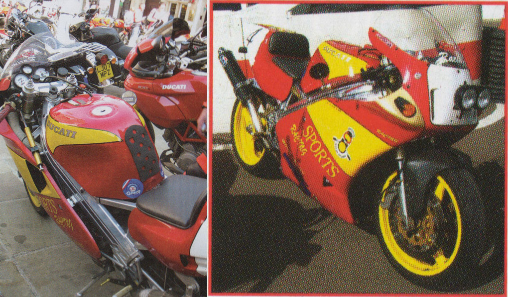

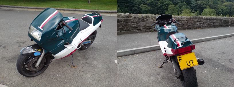

Here is a the Spondon Ducati I was thinking of. This machine is owned by a rider from Hampshire but I expect the frame spec is the same as yours. I don't know what Ducati engine is in this one. I notice you have yet to add a radiator to your Paso, that will give you a chance to connect the thermostatic valve correctly vs Ducati's attempt.

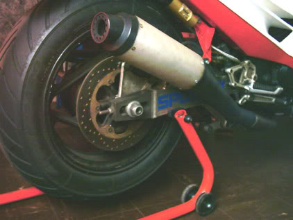

Here are a few images. You can see the discs' and the sliding adjusters (which are a bone of contention among other Paso owners)

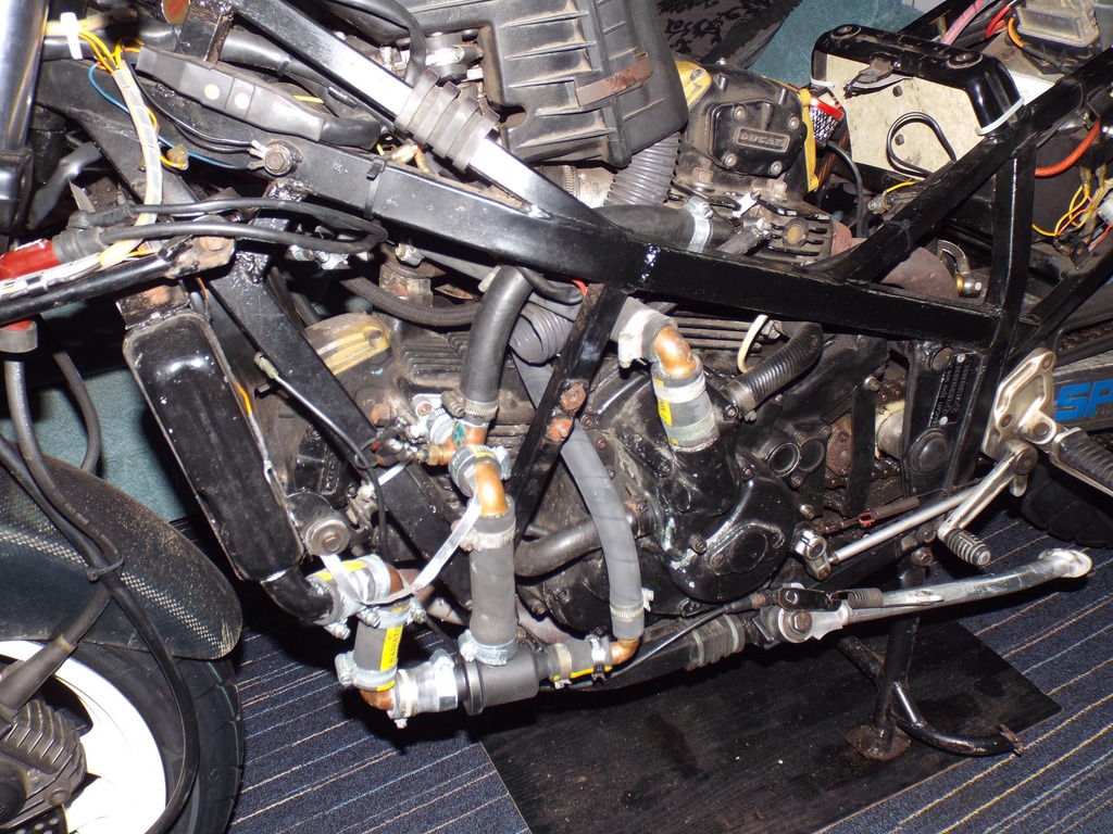

The Spondon floaters are a huge improvement over the standard cast-iron rotor braking which couldn't be much worse. How this bike got through TUV testing etc with that set up is beyond me. You might have some trouble setting up the radiator - thermostatic valve etc since the hose routing is far from ideal. These images show what I've done vs the standard set up. Blue is cold/cool water, Red is hot and Green is reheat for cold start-up. The problem is that Ducati are switching the thermostat with water cooled from the radiator. I noticed my 906 ran hot so purchased an Aprilia thermostat rated at 75C and when I removed all the hosing and inspected the Ducati thermostat it too was rated at 75C. I racked my brains for ages trying to think of an alternate method and settled on dropping all hoses underneath the frame and reconnecting there. Sorry about all the copper connectors, one day I'll send it all to Samco. There's no shame beneath a full fairing. The routing I have employed runs the water backwards thru the radiator but finally has stopped the over-heating. The 906 coolant hosing is the same on the 851 and they have made the same mistake. You buy a new bike that runs hot and is prone to over-heating. It's quite a blunder.

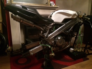

I've just dropped my suspension off at Kais, getting chrom & anodising redone and rebuild, £800 and may cost more if the internals need anything, so I'm crossing my fingers they don't :-/
