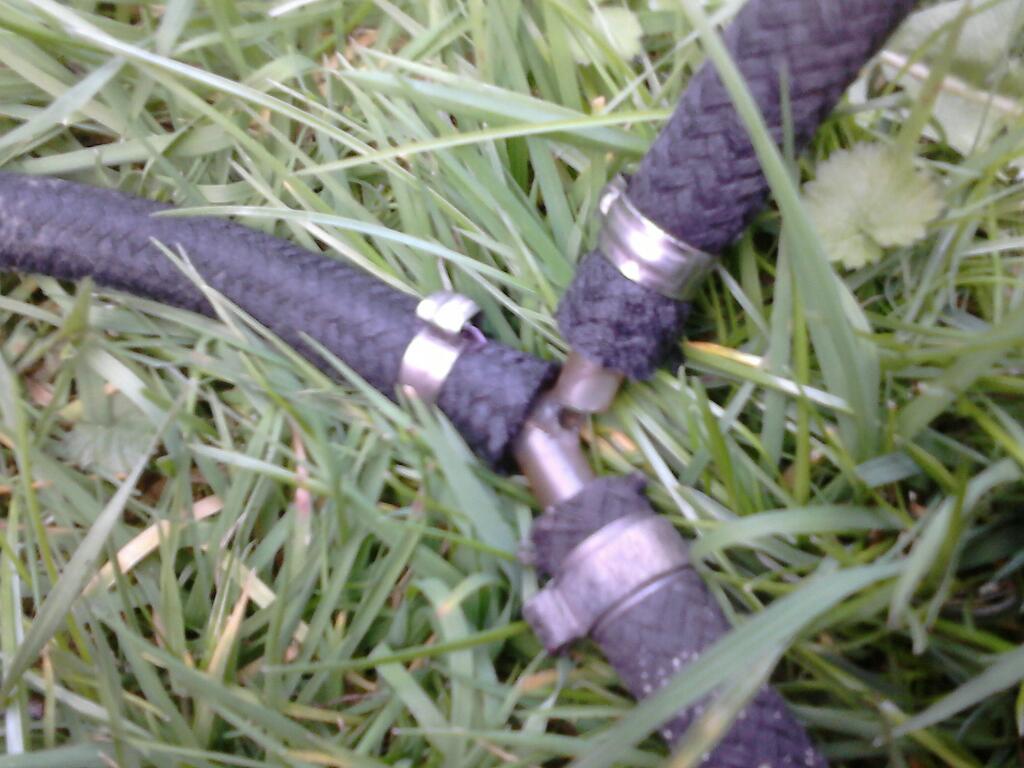

Hi guys, not been on for a long time as I didnt get muchuse out of the bike last year unfortunately. I've just got it out from winter lay up and I have started the riding season with a problem. The bike started fine and ran fine up until I stopped about 2 miles up the road for petrol. When I restarted it though it only ran on one cylinder. I got it home and put my extensive knowledge, know how and tooling abilities to work. After hours, ok it seemed like hours, I had exhausted my knowledge, know how and tooling abilities. Through swapping plugs and ht leads over I narrowed the problem to the front, or horizontal cylinder. I put that spark plug in the rear cylinder and that ran ok. I did notice that the wire in the pic from the back of the rectifier(?) was totally loose and not to mention the fuel line joint!! Could either be the cause?

assuming you still have the original Weber carb that broken Y piece is the split to the carb and the return line. You should have fuel everywhere.

Thanks Paso750. There was indeed fuel all over the engine and the floor. The blue wire runs to the battery negative terminal. I guess I'll start the elimination process at the weekend. I did try swapping the HT leads over and the same cylinder still wasn't running, so that's one thing I guess.

Um err G, if I'm not mistaken the N terminal on the battery is disconnected, god knows what that blue wire is meant to be attached to, and it would have been pissing fuel under pump pressure if the battery was connected with the split Y piece, so I think the post date has some relevance, if not I'm very scared indeed, and will go poke myself in the eye with a blunt stick, just because I can. :shock:

Then in that case the broken Y piece would be the most obvious and foremost problem to start with, fix it 1st before anything else, I may be a bit mechanically challenged myself, but if the bike started fine and was running along alright until you stopped and filled it up and tried restarting it, and I assume there would have been a strong smell of petrol by then? and it cut to one cylinder and died that should be the culprit, fuel starvation pure and simple.
If that doesn't work, move onto the next suggestion, one thing at a time. :D
