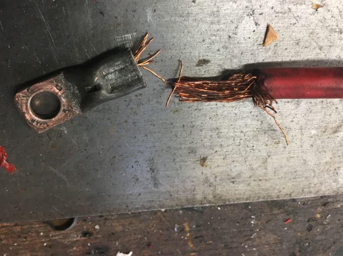

Great nudge in the right direction. I started to do some voltage drop tests and obviously started at the battery. The large + cable definatly had a worrying wiggle when gently fiddled with!!! When I took it out about 6 or more strands had fractured. Well that’s going to increase the resistance and eat into a bit of voltage. It then gets worse (or better if your fault finding) I could even pull out a couple of strands from the crimp area. iIRC a crimp should reduce the x sectional area to something like 95% of the original area. Clearly this crimp has never been properly since the day it was made!! I will make up a new cable this morning and report back. Have a hunch I have found the problem. Struggling to upload photo of dreadful crimp on phone- will try later on pc

I also had a bit of a pull on the positive lead mentioned previously when in a bench vice- well THAT was never crimped properly from new. Bloody well pulled out!! Did not go for a run after each fixed (that bloody body work!!!) but after both 'fixes' it now runs as it should so one or both of the fixes did the trick!! Also checked for any voltage drop after these two fixes and found very little drop through the ignition circuit. (The wiring mod FAQ post has a very good diagram)
Keith in windy London
ps all the broken strands in the photos were like that BEFORE I pulled it off. If it was a perfect crimp I would expect the crimp to hold and the strands to fracture.
