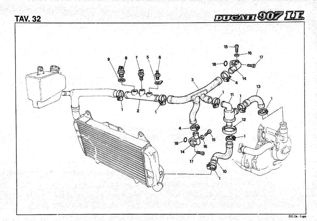

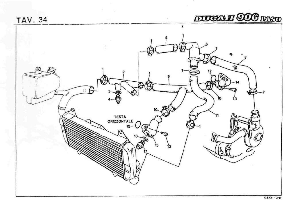

No, the coolant hoses of 906 and 907IE are not the same. Two or three small ones are but the main ones are not. Maybe you can try contacting Bruce from https://racebikebitzusa.com/ . He's the guy who helped getting the 907IE hose set made. As so few 906s were built I'm not sure if Samco would have any interest in making a set for the 906 but it's worthwile asking.
Finding a source for an original set will be almost impossible. Maybe if you search for the part numbers of every single tube over (a longer) time you will be able to get a full set together.
