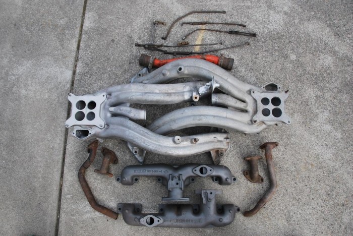

yep , check out this Mopar cross ram manifold for dedication to the long intake runner :)
