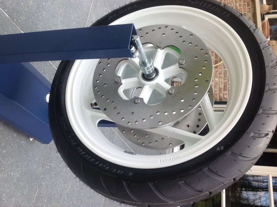

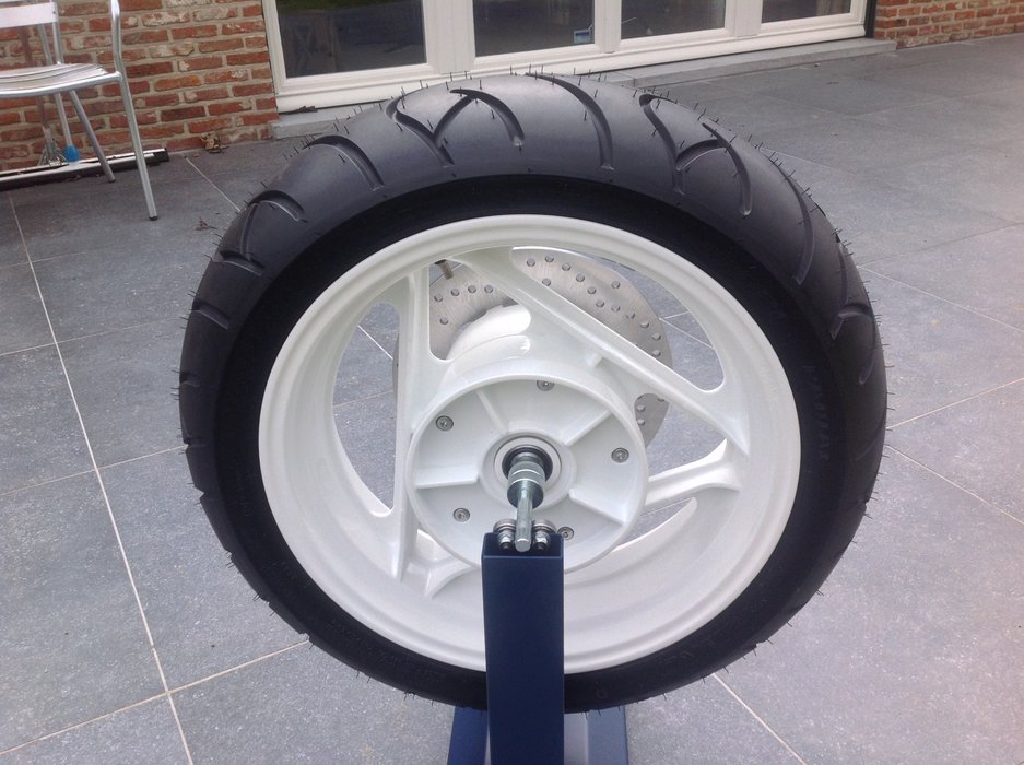

Hi, I agree with higgy.
Motor Cyclist magazin did test the Shinko SR880 & SR881 only 1 year ago https://youtu.be/bHnmukUJ7aQ
They were impressed how well they worked (sticky!) and for me: these are radials as the originals not cross-ply.
Assume tyre technology (especially radial tyre technology) today is much improved compared to the mid-80ties (Shinko is Japanese and are produced in South Korea - old Yokohama motorcycle tyre division).
Our Paso was the first motorcycle with radial tyre (front & rear) if I'm correct.
So even if the SR880 & SR881 are not the top of the bill, they are way better then the old Michelin/Pirelli's.
And for most countries: they are homologated for our Paso (also no issues with assurance companies if something would happen).
So like higgy said: why bother with alternative solutions.
Better even: only as long as they are sold, Shinko will produce them (and only our Paso uses these sizes).

You can order them (Shinko tyres) also from Germany:
MC Reifenservice Alfred Shenk (email: schenk@mc-reifen.com)
If you live in Europe and can't get them this is an easy and relative cheap solution.
For my Suzuki I pay almost the same amount just for the rear tyre :lol:
Front tyre SR880 130/60-ZR16 €107
Rear tyre SR881 160/60-ZR16 €120
P&P UK: 1 tyre €22, 2 tyres €25
P&P Italy: 1 tyre €18, 2 tyres €21
They supply almost every country in Europe, I gave these 2 (UK & Italy) as an example.
I have ordered them a few months ago and got them within 3 days on my doorstep.
