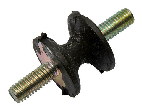

The Digiplex unit doesn`t seem to be that sensitive to vibrations as the large ECU units used on the 907ie and others as with them the silent blocks were changed to a different type. (pic below)
