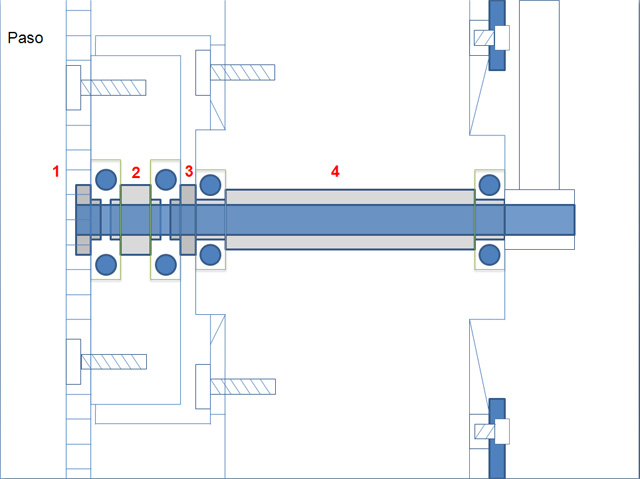

as it was said before the sprocket is bolted to the sprocket carrier (there are nuts on the backside). The sprocket carrier sits with the rubber cush drive behind it in the pan that`s bolted to the rim. What holds them together are the bearings and bearing spacers. In the end the torqued down axle. Below a simple drawing.
Nothing should jiggle or move. If the complete sprocket carrier would tilt a bit I`d check if the rubber cush drive is still ok, has shrunk over the years or whatever.
First I`d remove the wheel and then the sprocket to inspect the holes in the sprocket carrier. I had one with oval holes. Apperently the bolts had come loose at some point in the past and were just retightened. That didn`t work.
