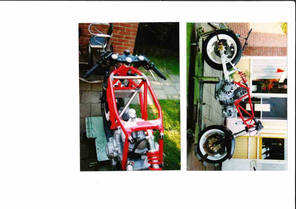

Hi Higgy,
you're right. I did this a while ago. Due to lot of things I didn't finish the project sofar.
File comment: Removed all the unnecessary iron and braced where required
 Post subject: Re: Frame Cutting/Chopping
PostPosted: Mon Jun 11, 2012 10:06 am
Posts: 338
AH!!!
I went all the way....
its nearly finished, 10 years working on this thing. :wacko: :wacko:
PostPosted: Wed Jun 13, 2012 2:08 am
So is it basically a 748 with a 1989 Sport engine? (which happens to be 748cc)
What is left of the Sport?
PostPosted: Wed Jun 13, 2012 4:47 pm
Posts: 338
PostPosted: Sun Jun 17, 2012 7:08 pm
Posts: 531
Location: holland
Hi Angelix,
very nice bike. Indeed you went all the way.
you finished, where I just started a long time ago.
meanwhile I collected parts such as
998R Öhlins front end incl. radial calipers
5 spoke magnesium Marchesini's
S4R swing arm (Aluminum sculputure)
changed the frame end to adapt the S4R link instead of the original cantilever.
But first I have to finish some other projects such as proper lathe to machine parts.
Bertus
