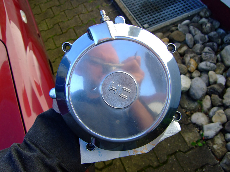

another option to fix the problem for good would be polishing the cover.
 Post subject: Re: brake/clutch fluid resistant paint
PostPosted: Fri May 22, 2020 2:56 am
Posts: 509
Now there's a thought, that's something I can do, have you seen this done on one of these, I might give it a crack, nothing to lose really if it looks wrong just paint it
PostPosted: Fri May 22, 2020 6:30 am
I had two polished ones but to be honest I prefer them in black ;)

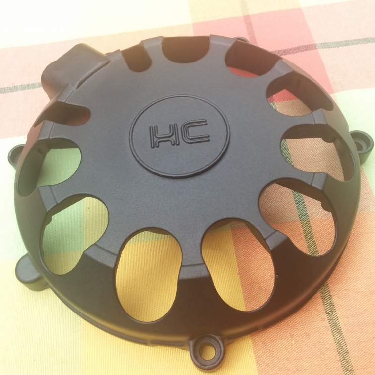

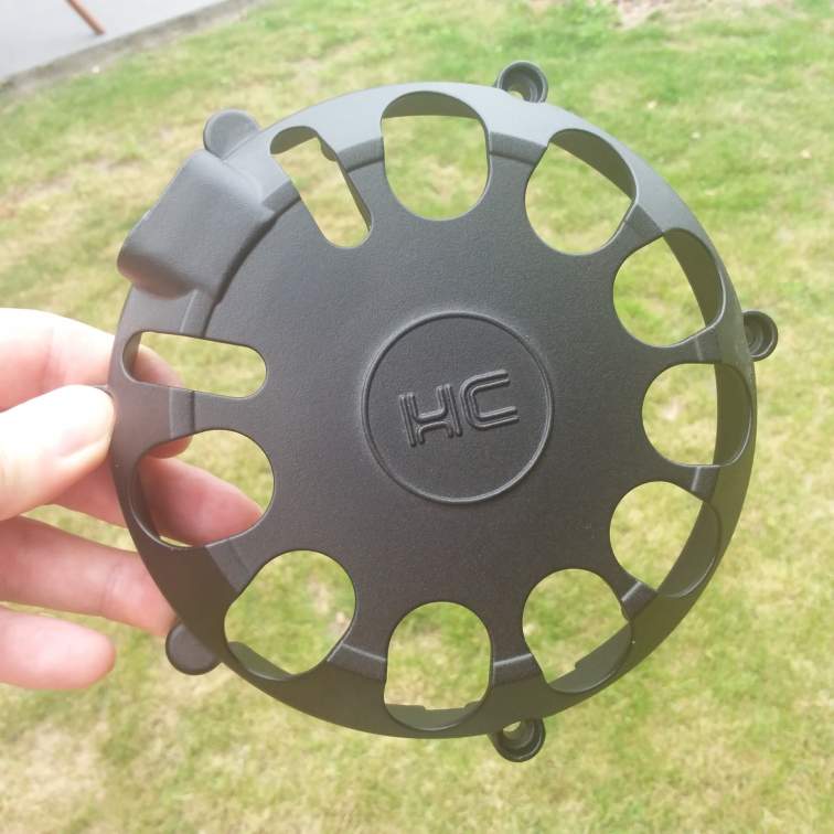

Nice, do you think the drilling is the way to go
PostPosted: Fri May 22, 2020 11:11 am
Posts: 261
Here I've a little relief in the paint (difficult to see on this low res. pics), looks nice in reality.
Is powdercoat by the way.
