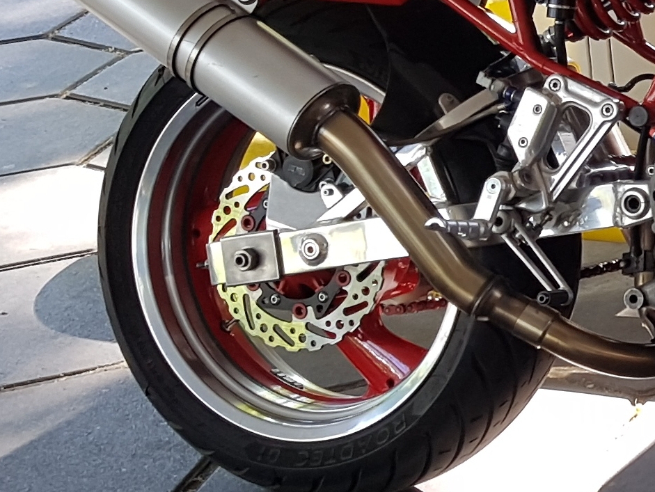

After quite some search throughout the web I finally ended up with a BrakeTech disc.
I was looking for a floating rotor.
https://braketech.com/axis-rear-floaters-2/
 Post subject: Re: Rear brake disc alternative
PostPosted: Fri Jun 08, 2018 4:22 pm
From what I understood Michael has the old brake disc on his new rear rim. The brake disc bolt pattern of the 16" and 17" rims is different so the BrakeTech one won't fit.
Looks nice tho. All the rest does, too :thumbup:
PostPosted: Fri Jun 08, 2018 11:16 pm
Joined: Mon Mar 18, 2013 8:05 pm
Posts: 13
Location: Denmark
