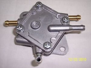

Okay, I took up dirt bike racing and got a little lost on getting my 750 Sport running well again.
I now realize I have no idea how to install it. I have the dual DellOrtos. There is a cap screw sticking out of each of my intake manifolds (manifold going from carb to cylinder). Do I put an air nipple into each of those, run it to a T, then into the vacuum line of the pump? Will this pump work? It has 4 nipples with arrows. 2 arrows are going out of the pump, one arrow is going into the pump and one nipple has no arrows (is this the vacuum?). Any help would be greatly appreciated. I now know this may not work...

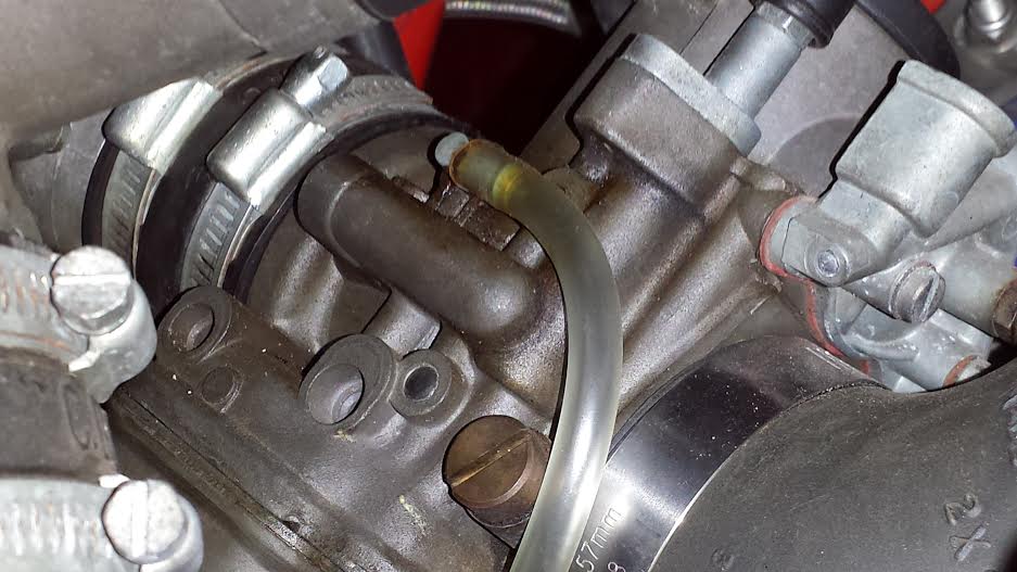

Each carb has this nipple, this one just has a hose that goes to the bottom of the bike like a drain. The other carb's nipple has no hose. If those are the vacuum lines, I think I can figure this out.

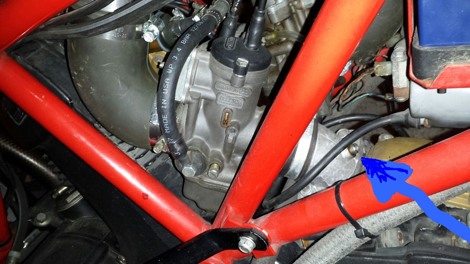

Can I put a nipple in this screw hole (where blue arrow is pointing at the screw) and use that as the pulse vacuum?
 Post subject: Re: fuel pump, rough running.
PostPosted: Mon Feb 23, 2015 7:34 pm
yes. The only thing is that you will have to remove the vacuum line for the fuel pump if you sync the carbs as that is where you would connect the sync gauge.
