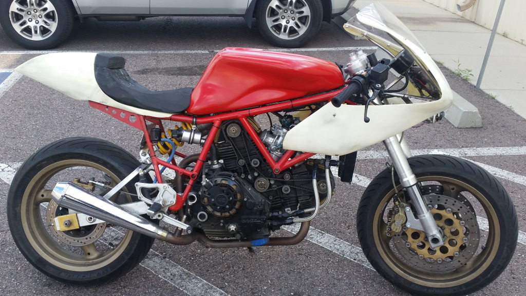

so you may remember this bike from a couple years ago. last winter i decided to bite the bullet and do all the things i'd always thought of doing to it. here's a summary:
- modified frame (rear section cut off, shock mount relocated).
- wheels, forks, brakes, shock from '01 900ss.
- dellorto phf 36's.
- new tank from fuelcel (i built my own tank previously, which i think looked really awesome, but eventually it started leaking - don't think i'll try building tanks again, too much trouble).
- 916 oil cooler.
- hid bixenon headlights
- led 916 taillight
- bespoke front fairing/gauge subframe.
- bespoke fiberglass fairing and tail (i started with a 916 windscreen and nose, but it ended up being very different).
- koso tnt-01 multifunction gauge.
- dynotune o2 sensor

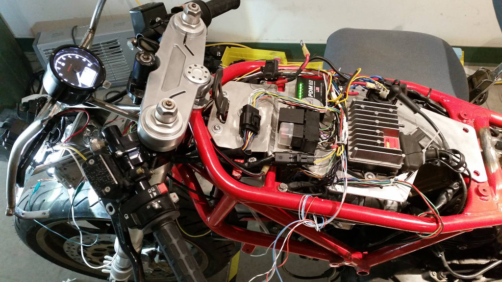

- completely rewired everything using a pdm60 (http://pdm60.com/). all high current wiring was removed from handlebar switches and controls. i didn't realize when i bought this thing, however, that circuits are not individually switchable, so i ended up with several relays anyway.
- slime fighter oil separator at case breather (http://www.aircraftspruce.com/catalog/e ... imeftr.php).
i still haven't weighed it, but my guess is i'm now around 360-370lbs. now getting dellortos dialed, and lemme tell you, they're wonderful. to say nothing of the new rollers. as some people have mentioned on this site, the 17" conversion is totally worth it. i can't stress enough how well this thing handles now. absolute bliss. it turns in without you even thinking about it, and holds a line effortlessly. absolute bliss. i don't know how i ever put with with 16's before. easily the finest handling machine i've ever ridden (though i haven't ridden anything newer than say, 2005).
anyway, enough gushing. it's still pretty rough, and lots to do, but it's summer in the rocky mountains which means i ride.
peace - ian.

Thats looking really pretty mate and the seat looks comfy. The tank looks like a reworked SSie with the bollock pad recess and centre crease filled in. Like the front and rear lights, very subtle. The front end looks a bit high, have you tried dropping the yokes down the legs a bit.
Are you going to put a front guard on it? A SSie or monster will fit direct with the oe nylon clips. Can I suggest a monster with about 75mm chopped off the front, I did that to my naked SSie and it looks well and also protects the motor better with the longer tail.

thanks for the compliments. you called it on the fuel tank. fuelcel makes a streamlined version of the 99+ 900ss tank: http://eti-fuelcel.com/Ducati900SSpost.html
forgot to actually post a pic of the tail. it's one of these: http://www.motodynamic.com/94-04-ducati ... smoke.html
i haven't played with the fork height yet. i'm a little worried about contact between front tire and the oil cooler at full compression, and it handles so well. i do have a front fender with the nylon clamps, but i just haven't put it on yet.

What does that pdm60 exactly do?

Interesting build. That front end and 17"s surely made a big difference.
What did you do to the rear shock mount? I can't see any difference.
Two recomendations
- 2" (50mm) rubber elbows on back of the carbs. It will improve the drivability, and make it easier to tune the carbs.
- big fat clear hose from the crankcase breather tube, to the back of the bike, like the old singles and bevel drives.
Oh, and the last thing. Ride it lots. Keeps the smile on your face and your blood pressure low. Fun bike. Light, simple, and enough horsepower to keep up with the locals.

pdm60 basically replaces your fusebox with 60 amps worth of electronic breakers. a single internal relay switches everything, which i found a little disappointing. i think each circuit should be independently switchable. instead, i ended up with three other relays (ign, hi-, lo-beam).
most 900ss shocks are shorter than the unit that came stock on our bikes, so i cut off the old shock mount tabs on the frame and welded on new ones. this moves the whole shock down to put unloaded swingarm sag where i wanted it. also has the effect of steepening steering head angle and quickening handling somewhat. i'm not exactly a suspension guru, so i'll likely spend the rest of the summer trying to dial rates and damping.
crankcase breather now talks to a dedicated air/oil separator as you can see in the pic above. engine oil drains back to the case. there should be zero oil coming out of the filter, but i'll be watching it for a long time til i'm sure.
thanks for the tip on the sight glass. i've always been a little leery of these plastic ones, though i now have 500 miles on it.
