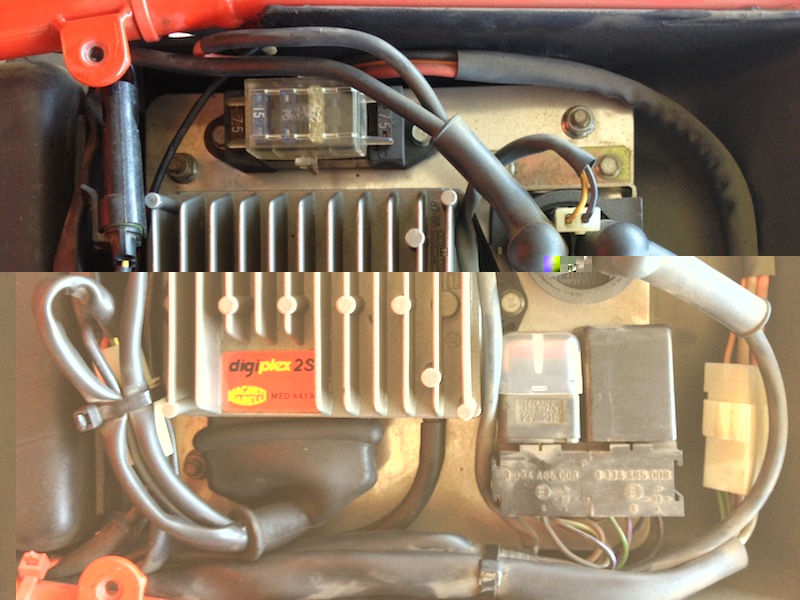

I installed the relay mod and it didn't increase the voltage at the coils at all (which is at 2V!) I guess it is possible the bike runs at this voltage. What happens is that when at idle it's somewhat hesitant and at a quick twist of the throttle it looses power and stalls. When riding though, it pulls very strong and I was able to take it to 120 quite easily. I know now, that the faulty plugs are most likely caused by the low voltage at the coils....
The wiring is absolutely intact and I checked over the connections. While looking things over I started to measure the voltage to see where the drop might occur... It isn't on the positive side of the current but actually on the negatives which go to the coils. I traced the wiring back to the Digiplex and it looks as something happens inside of it which causes the ground (negative) that enters the unit to drop the voltage down so significantly when it exits the digiplex - quite confusing (?). When I check voltage of the positive wire going to the coil against the negative, it is 2V and if I test it against a solid ground it is 12V. The ground entering the Digiplex gives me a reading of 12V.
Like I said in my earlier posts this bike is a time capsule and nothing has been modified on it so what exactly might be going on? Is the a simple fix for this or should I look into a new Digiplex unit?
When I got the bike, the plugs installed were the Champion RA8HC and I switched them over to the RA6HC. This is somewhat confusing as well... The sticker on the inside of the fairing states RA8HC while the workshop manual and the owners manual state RA6YC. I know this was replaced by the newer HC but why the two different heat ranges??
