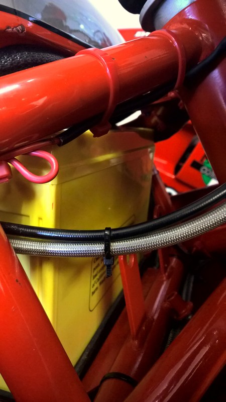

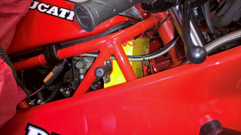

I just tried to put a motobatt Mb16au in my 89 750 sport to replace my YB16AL-A2. The motobatt is about 2mm thicker and flat out doesn't fit in my bike. Maybe I could bend the regulator mounts and force it in but I'd have a hard time changing the regulator if I did so. Just FYI.

Would you be able to do me a favour and send a picture by any chance? Is your regulator/rectifier mounted in front of your battery? Mine is so I can't insert the battery at an angle without it hitting the bolts that hold the regulator.

 Post subject: Re: battery suggestions?
PostPosted: Thu Jul 28, 2016 4:14 pm
Posts: 65
I dont think these pictures will be a great help without the tank off :-(
PostPosted: Fri Jul 29, 2016 8:54 am
Joined: Sat Dec 19, 2015 6:06 pm
Posts: 12
Location: New Zealand
Oh no, they help alright. Thanks :)
I see you don't have your R/R mounted on the two brackets welded to the frame in front of your battery. It's those that stop me getting the battery in (the battery has to go in at an angle because it's slightly wider and it hits the bolts that hold my reg on).
I think I'll have to ditch it. Where's your R/R? Under the seat?
